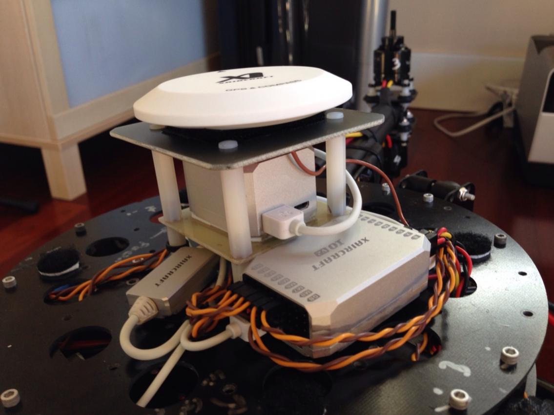

Anyone else using the XAircraft GPS/Compass folding post to mount their GPS puck on? I spent a week trying to figure out why my SuperX compass wouldn't calibrate and always showed red at the end of the calibration process. If I put it in to GPS mode it would be yellow which is indicative of magnetic interference.
Finally, I took the GPS off another copter and it worked just fine. I thought it was a defective GPS until I did some more testing. I realised the only difference between the two units was that the one that worked was on a post that didn't have any metal on it below the GPS like the one sold by XAircraft does. I did some more testing and found that just moving the GPS a few millimetres above the puck mount cleared up the magnetic interference. I couldn't believe it but I tested it several times and it certainly was the puck post that was causing the problem. I installed it on another post that uses a plastic head with no metal at the top and it's now working fine.

That is pretty strange. Mine sits on a copper PC board with no problems at all. Quick satellite lock.
