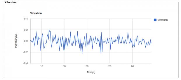

now here when the super x is working properly look at after picture of the level

While I understand what you guys are saying (obviously the further from the center the weaker the boom, and the further from the hub the weaker the tip), I hope you're not suggesting that the superx is not supposed to be with rigs spinning 12" or more props.
I am banking on the fact that this thing can be smooth, and at least close to vibe free as possible, as long as the props/motors are in balance, and level.
There are plenty of pro's flying large rigs with SX so you should be able to do this thing. As a hobbyist I have found that smaller craft with smaller faster props behave better in wind, are more portable, and fly longer between teardowns. They already shoot pretty decent video and as cameras improve, you will start seeing the pro rigs get smaller too.
I hope not either. I run 13s on one SX bird, and 14 or 15s on the other. Vibes are sub 0.4 on either machine. High vibes on large props ? Loose those plastics and get into some woods or CF. Above 12 inches or so, plastic, even filled plastic, is just not an OK material for props. Only time I use 'em is on madiens and testing where you might chew through a few as you trim it in.

Has nothing to do with what your saying, I had bearing issues with 10 hrs on my tigers that made it impossible to get balanced. Bigger props only amplified the problem.
I'm getting .2 and lower now:) If you find Kloners log post you will see he's lower then .1
That's really low. I'm getting .4 with nylon/carbon props. Just put cf props on and will test today. Hoping for similar numbers to yours.
