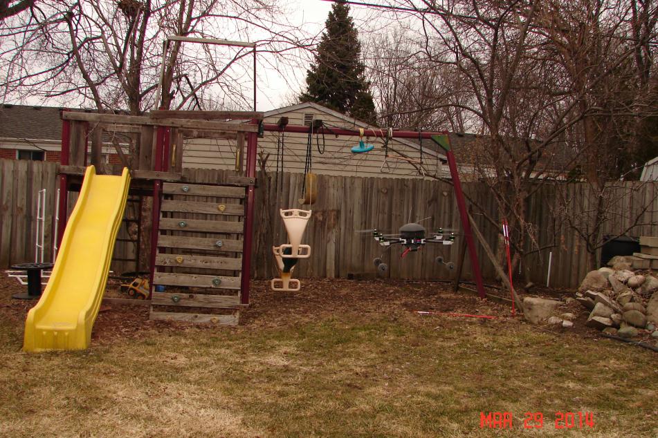

Well I got it off the ground tonight! about an inch. :)
Inside the house:black_eyed: It's raining out so I need to wait a bit and go outside. Everything seems to be connected and functioning properly.
I started without props, verified rotations and correct motors reacted with the radio inputs. Then I put props on held the frame firmly and gave it a little throttle (just enough to spin).
I checked to make sure the quad tried to correct for out of level conditions. So far So good!!!

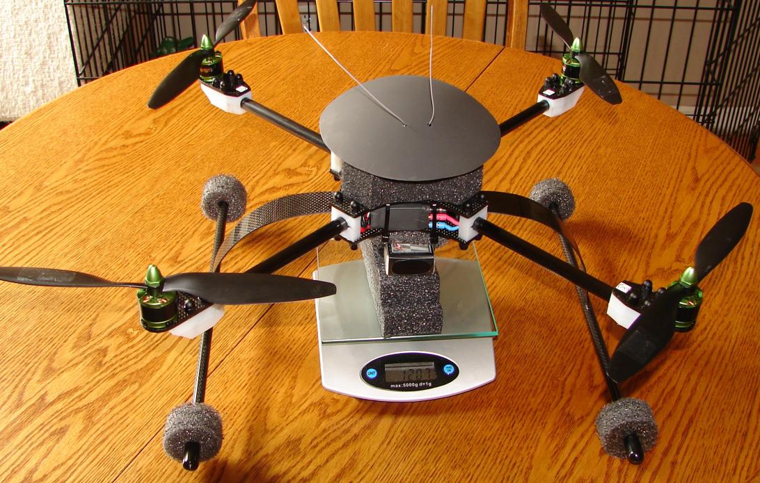

I got the lid mounted.:) It's made from an 8" acrylic light fixture globe. I cut three of them from one globe. To mount it I had originally planned on using some handmade fiberglass or plastic brackets. The other day at work They were throwing out a bunch of harder packaging foam that some computers shipped in with. So I grabbed it and cut out a lid mount from that with a band saw. It cuts like butter with a 1/8" X 14 blade. I used velcro to attach it to the frame and the lid. Next time I make one I'll use my scroll saw to cut out the center hole so there is no slice through the side. Here's how it looks complete. I will be also adding some lighting soon. AUW is now 1207 grams.

We are airborne!!! lost a propnut though...I though I had them tight..Off to HomeDepot for some nylon stopnuts...:) I'm happy!
Toymaker
Crashologist
The thing that amazed me was how high the blade went! It had to have gone 50+ foot up in the air lol!! then it took forever to come down kind of like a Maple tree spinner seed. The nut is nowhere to be found.
The motors are the multistar type that have the flats at the base of the 6mm motor shaft. No prop adapter at all.
Btw when I got bac from the store I put the stop nuts on and flew again for about 10 seconds and the battery warning went offf DOH! lol
This thing is going to be fun to learn to fly! It is very stable and has tons of power. It's lifting off with a little less than 1/2 throttle.Full throttle take off leaps off the ground!
