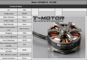

I know the set up sounds kind of big but the reason for the Ice Lite 50s is the refresh rate. If there were Phoenix 30s I'd buy them instead. The T-motors are suggested for the Carbon Core 650 and the 950 on the Carbon Core site. View attachment 8632I know the Axi motors are really good motors but not cheap.and I also haven't seen Axi that are comparable to these T-motors. Like I said, I really appreciate the advice and comments.

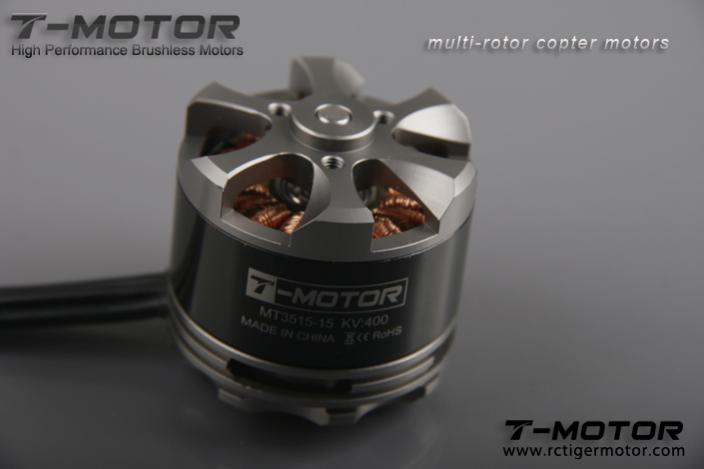

Carbon Core is also suggesting this T-motor View attachment 8633
http://clubheli.com/Tiger-Motors-MT-3515-400KV_p_4190.html

I hear what you guys are saying but when I compare the specs of the T-motor 4008 to the MT-2814-10 it would seem that the 4008 is way more efficient.
When you look at the specs of the of the 2814s at 14.8V on 12" prop the amp draw at 85% is 23.7 amps. But, when I look at the similar specs for the 4008s the Amp draw on 12" props is like 12.2 Amps. In addition to this the thrust is much higher to. So what am I missing, why are the 4008 not such a great choice? And any idea why Carbon Core would recommend them? I'm not complaining or criticizing, I honestly think I must be missing something or misunderstanding something.
DennyR
The 4008's are good motors, the thing is that with the low KV you may run out of RPM if you use small props. at 14.8v.
i.e. the 10x5 Graupner Eflite would be too small and it would lift off but not have enough reserve left to stabilize the model.
something like 12x5 or 13x5 with DJI 30Amp. works OK
Cool this is really helpful, I think I'm getting it. Well my intention was to use at least 12x5 props on the the 650 or something like 13" or 14" on the 950. I'm pretty set on the Ice Lite 50s because I heard that with the firmware update for multirotors the refresh rate in Hz is even faster than the Simon-K ESCs which would make that even faster than the DJI Opto ESCs. Plus I can get a good deal on the Ice Lites.
