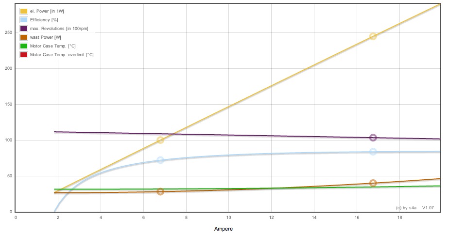

I'm not sure I totally understand the graph.
Is the efficiency good on this graph? Sorry I'm kind of slow.

the sunnysky brand are alright. What are you building again?
that is a 250 watt 12" 4s prop..... Mine are like 350 watt 4s 12" in 2814 770kv------ avroto/tiger/leopard

The chart I posted is from a Pulso 2826/12 (760)Kv running on 4s.
I tried to get a chart for the Sunnysky motors on the eCalc: calculator to multicopter but the Sunnyskys were not in the list.

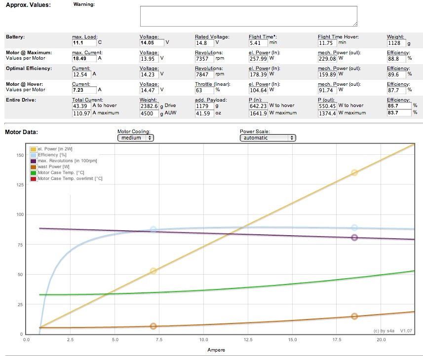

Hey Guys,
I'm revisiting those T-motors, the 4008-12 (600kv) and I ran them through the Multicopter calculator.
I chose total weight of aircraft 4500g, 50amp ESC, on 4s 5000mAh 30/45c X 2 in parallel, 6 rotors 13" 4.5 pitch. And from what I can tell the they look pretty efficient. Here's a screen shot of the calculator. I may not completely understand the calculator, maybe there is an online tutorial on how to properly read this chart/graph.

Never mind about the tutorial, I understanding it better now. Just needed a bit of a learning curve.
I can see now that the flight time kind of sucks. I'm going to rethink this model, cause I really want a longer flight time.
I remember hearing that the S800 is boasting a 20 minute flight time, I'd like to know how they did that.
