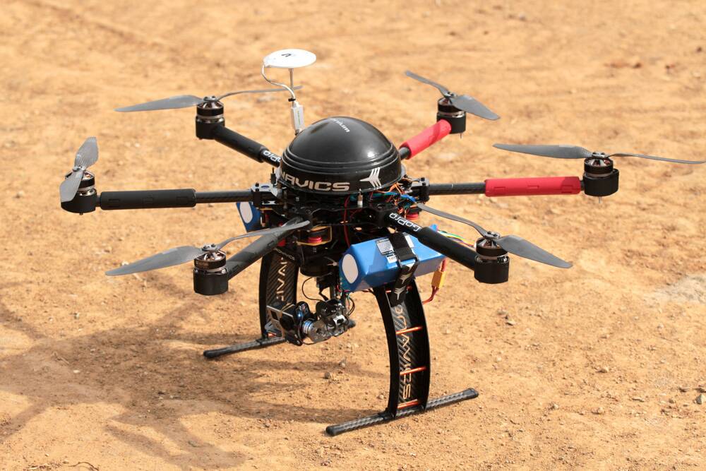

I recently bought a Naza v2. I suspect it may be sold before it comes out of the box! The SuperX is looking good...
Pete
nicwilke
Pete,
You are correct, very boring. I'm just getting this hexa from 4s to 6s so I have been a bit cautious before gunning it. I'll get some more footage of it actually flying somewhere.
