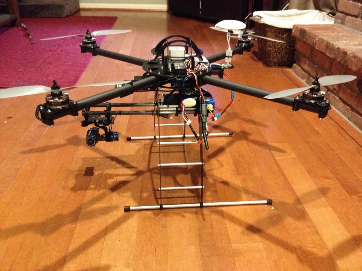

Nice little quad setup you got there SleepyC, what's your spec's? Like the rail setup for the gimbal, who makes it? Looks about the size I'd like to build to replace an aging HoverThings VC-450.

T-motor 740KV, 4S system on 40 amp Ipeaka ESC's. DIYQuads 530 frame (long arms http://www.diyquadcopters.com/QuadFrame-530-HD_p_52.html)
Quadframes US landing gear.
The rails are just Carbon rods attached to the gear. cam is counter-balanced with the batts.
Tarot 2D brushless gimbal.
I'm using 6000mHa 4S packs and getting 10 min + 2 to spare.
The little sucker rocks. I built it hoping it would be a cool little goPro rig and it ended up kicking butt.

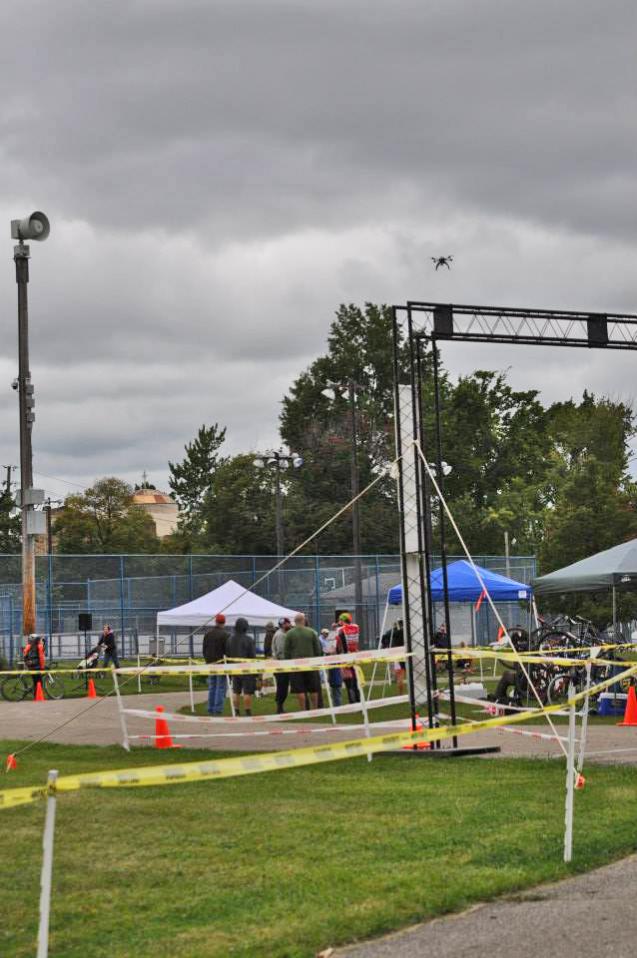

The producer took the footage shot all 2K and 4K on the Blacks, but I was sent a few "shots" of me flying.
View attachment 13763View attachment 13764View attachment 13765

That a mountain bike or road bike race event?

It's a cyclocross race, (I actually race cx as well, i raced earlier in the day and flew the rest of the day it rocked!)
Cyclocross is like a 1.8 mile dirt crit with barriers, stairs, run ups and such that you need to dismount and run and then remount.
It's HARD. 40 min of flat out, 185 bpm craziness.
