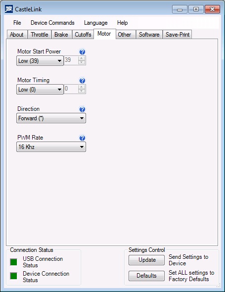

I guess what I am asking is what motor timing is everyone running with the Super X and is everyone using SimonK firmware?
Wayne Mann
No SimonK here either.

Anyone running SuperX with KDE Motors/ESCs? I'm running into a sync issue that is only present when plugged into SuperX. If I connect everything to my receiver (FrSky x8r), there's no sync issue.
I'm running KDE 4014 motors, 55A ESC's, and 18" CF props. Here's a video of what is happening...
