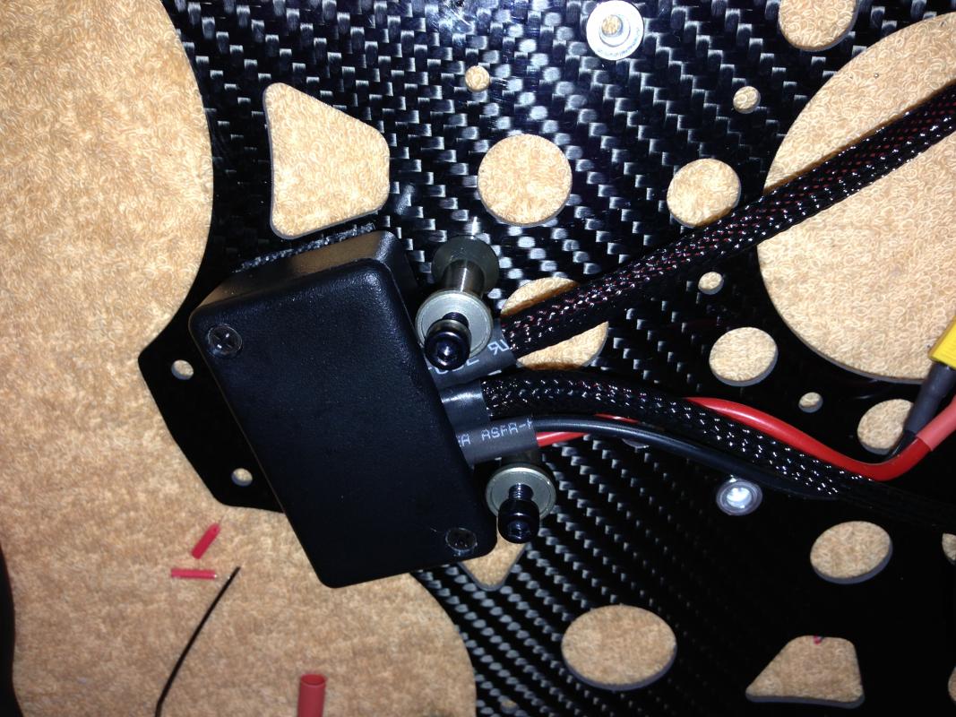

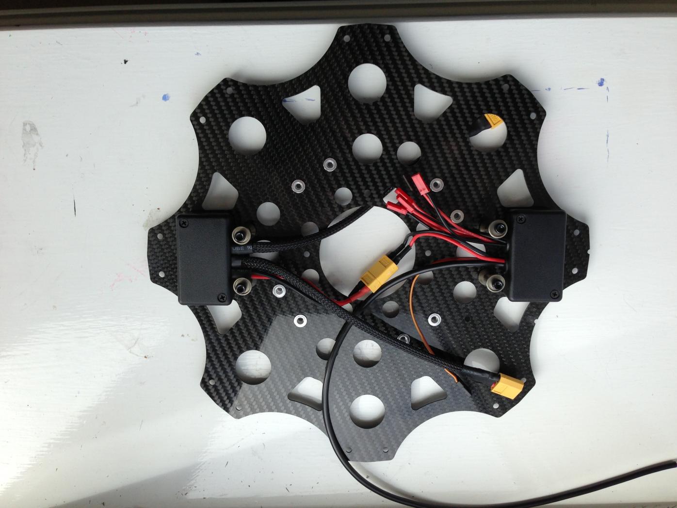

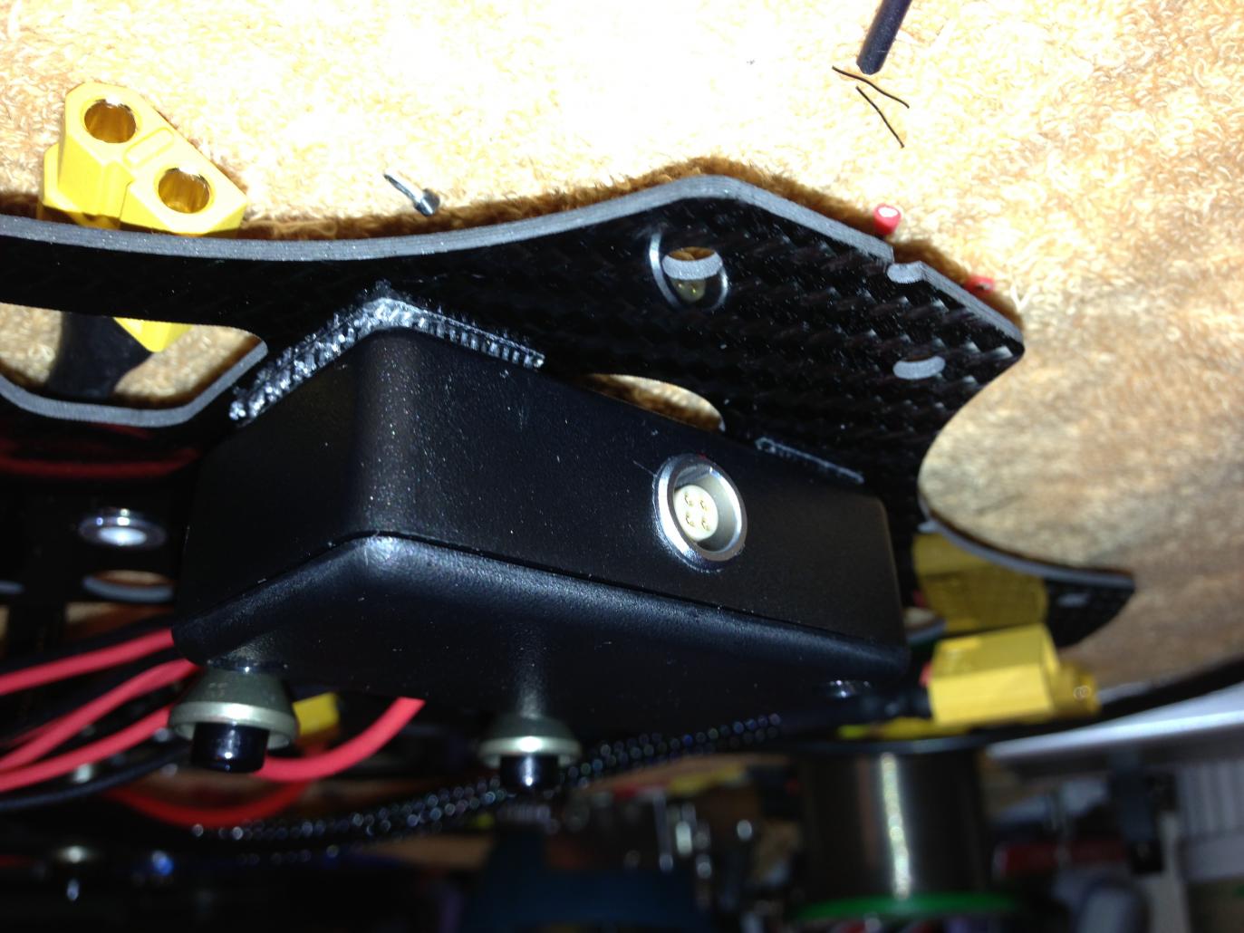

Hi could you tell me about your traco power boxes?
Sure Ryan
I wanted a 12 volt supply for the LED's and the Video TX (and any other 12v requirements)
I have used the Traco DC/DC converters before on other projects and they have been great.
On my build one Box 1 has the Traco Converter in with a 24v (6s) input from the Herkules III, a 24v loop output for the Zenmuse, and a 12v output to Box 2 which has 12v input, 4 switched outputs for the LED's via a receiver switch, 12v output for my video TX via the 4 pin lemo (+12/Gound/Video+/Video Ground) and a video input from the IOSD
DC/DC Converter:
http://uk.farnell.com/jsp/search/productdetail.jsp?sku=4173582
Box:
http://uk.farnell.com/jsp/search/productdetail.jsp?sku=3536427
Receiver Control Switch:
http://www.electriflite.co.uk/store17/index.php/lights-and-switches/tr-rcs.html

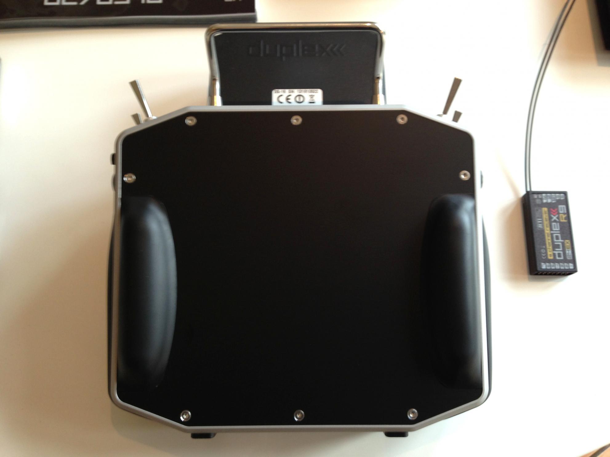

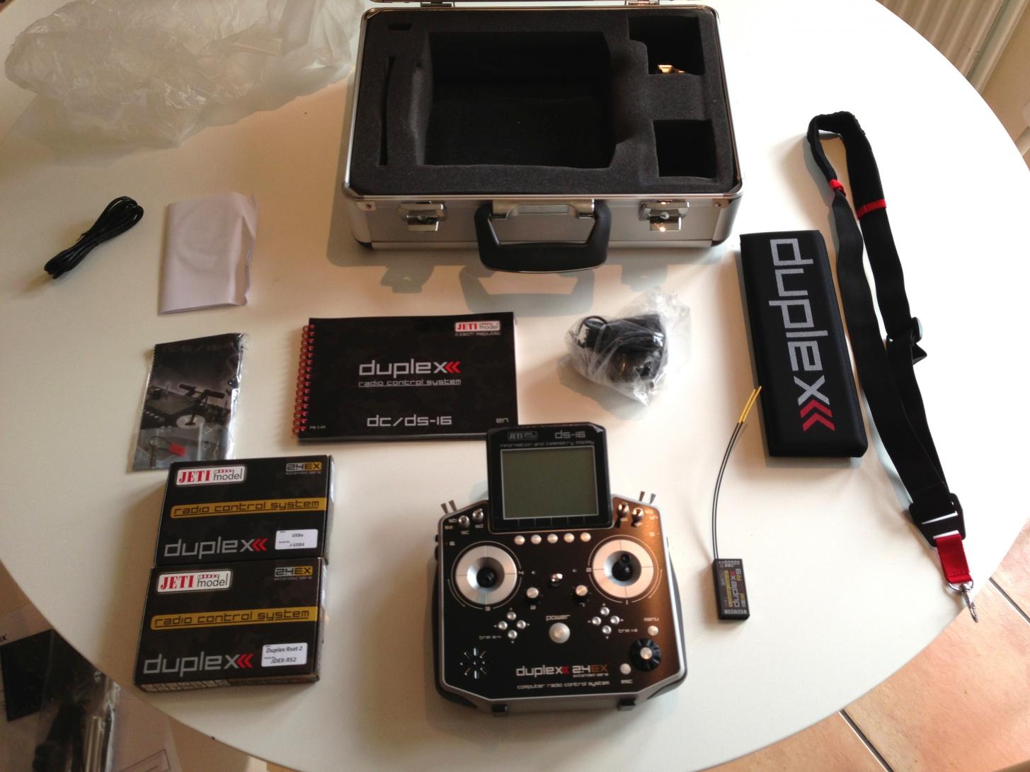

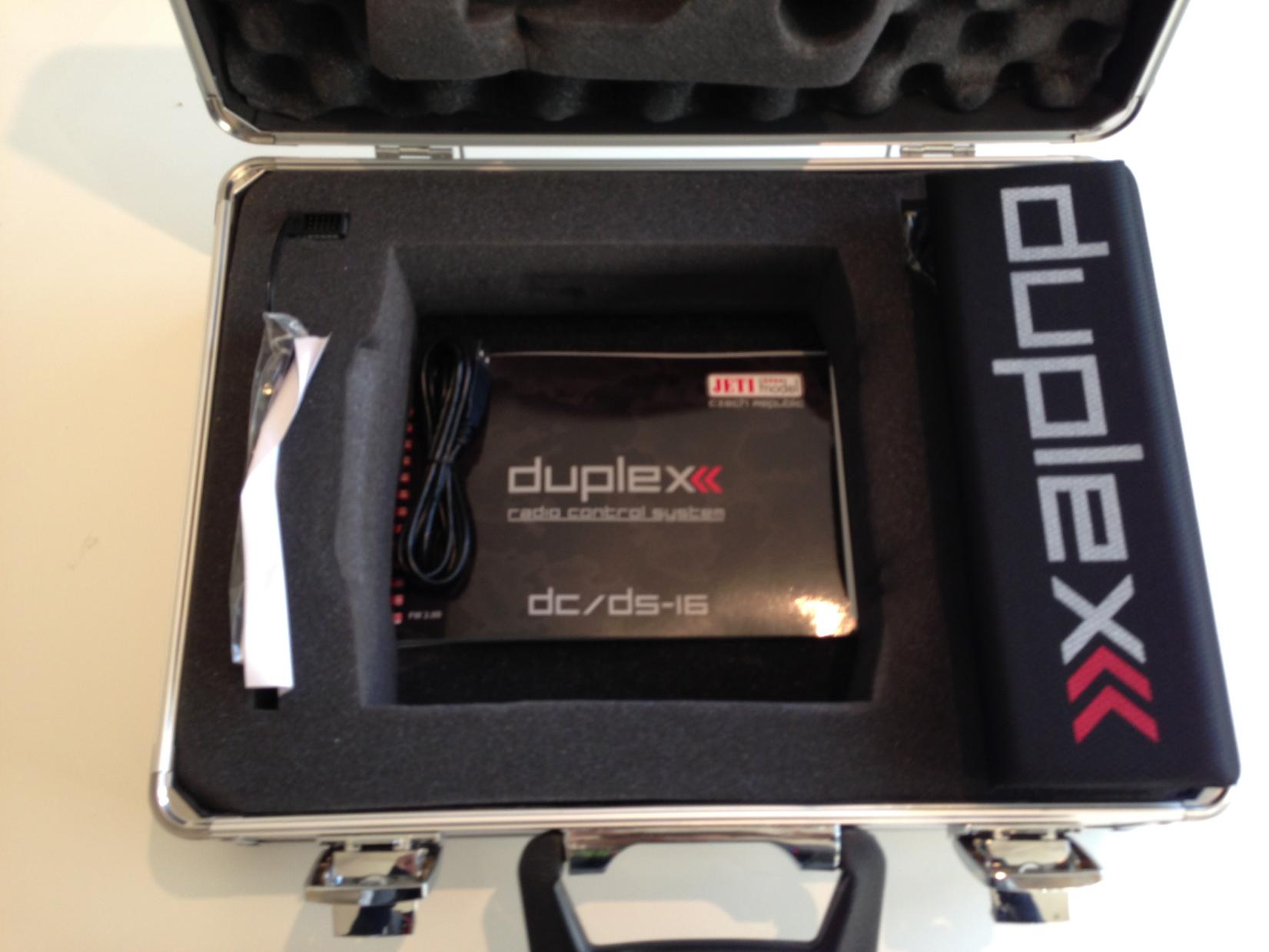

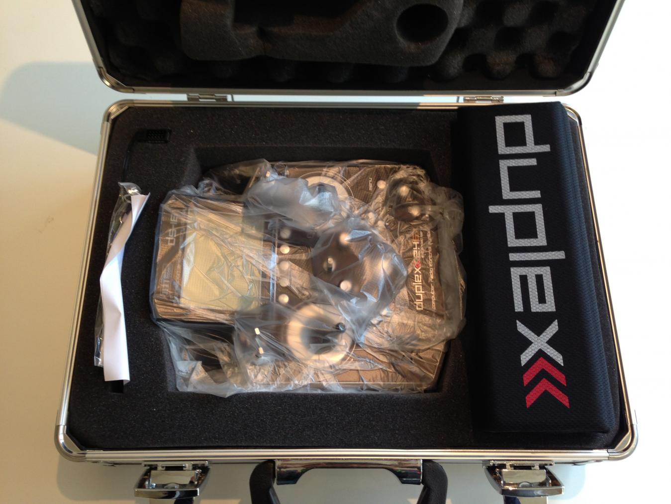

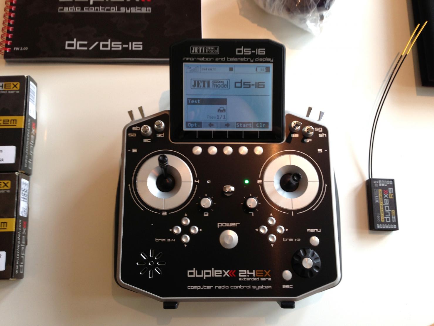

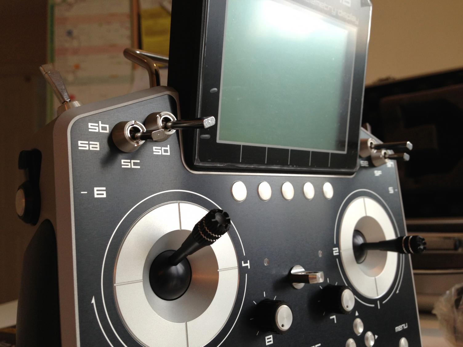

DS-16 Arrived today :)

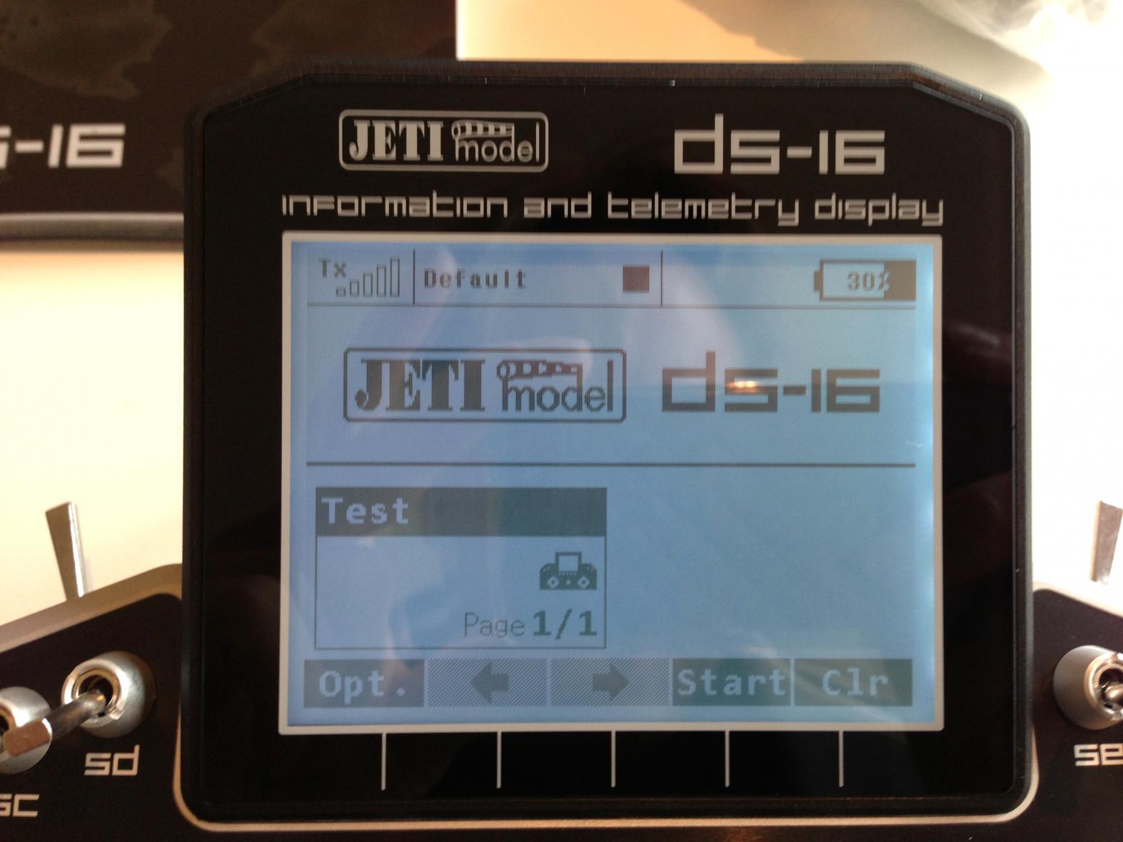

So have set up the DS-16 with the WK-M....
Need a bit of help setting up the Telemetry Board with the DS-16.
I have flashed the Herkules III with the PPMT variant firmware as per Andreas instructions and flashed the Telemetry Board with the Jeti firmware...
I want to know how to get the displays up on the DS-16 screen for mAh used - temp etc... any thoughts?
Thanks in advance:)
BorisS
Thanks in advance:)
Hi Beja,
first check in the menu of the DS16 if it has a connection to the tele board.
In the ds16 menu go to timers/sensors than sensors and logging setup. There you should find the ddifferent telemetry outputs of the board. Select which ones you want to have displayed.
if you don't find anything there there is no communication between the tele board and the DS16.
boris
baja-king
Here for the ride :)
Thanks Boris, When I tried that earlier only the RX voltage appears...
BorisS
Okay than communication wise tele board to RX to DS16 something is not working out ! I don't have the tele board yet so I am not familiar with it !
One more check you can do though. In the DS16 in the menu under advanced called jetibox, Click that and see if you can find any reference of the tele board if not than for sure the board is not running or communications is not established.
For sensors to show up though in the DS16 it can take some time though ! So try it a couple times !
