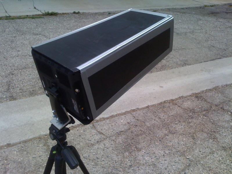

Kloner you are the FPV guru. After seeing your ground station, I was tempted to organize an intervention :). I enjoy reading all your "fpv" post. You have me pretty fired up to build a dedicated fpv rig. Only thing kind of holding me back is the fact that I can hardly see outside without polarized sunglasses. You have any recommendations there? Currently I use an Haier monitor on my AP ship but honestly, I cant see it unless I take my glasses off and to do that I need to be in shade. works for quickly glancing to frame a shot. Cant imagine flying that way though.
Build looks awesome, look forward to your reviews of the ship.
I made a shroud / hood for my Haier out of coroplast, tape, and velcro. Lightweight and works well in bright sun.

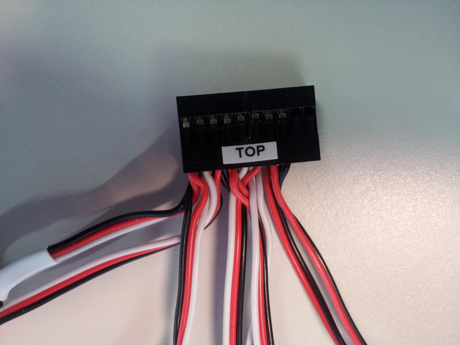

Can't stop messing with mine. esc's will come in this week then i just gotta decide on what cam i want. might try these security2000 brand cams, gonna look more into it. Then it's maiden time
Just about got her done. still needs esc's and a camera. Went with the securitycamera2000 pixim 690, like the tbs69. dji esc's will be here tomorrow, i'll test fly it then.

this thing is noticeably lighter than mine in hand, by alot. Think a friend wants it, might sell it and do it again
azure
Kloner, looks really sweet. Nice, clean job. Looking forward to seeing some vids.
Appears that you've got a NAZA tucked in there. Are you going to add GPS?
Probably, wanna see how that pans out with others first. I've been having a heck of a time finding a sweet spot for the ET sat ant. thing gives me a fit every trip, tracker stops following on my other rig. dunno if it's the solar flares or my setup. seems like everytime before i go the news shows the sun exploding. i'll see from 8 - 12 sats lock up and it'll vary during a flight. Weird,,,,,, not sure if it's the uhf, the video, what..... Shooting for simplicity and a killer signal on both systems so can get this thing down low out far
