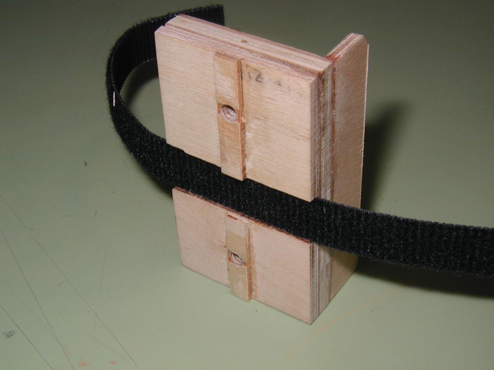

With my X650 flying again I've been able to turn my attention to getting the video Tx set-up and my GoPro mounted. Most of the time my equipment is sitting in the basement so I have to bring things up to the 1st floor to charge batteries and I wanted the GoPro to come off and go back on easily. To that end I made a small mount for it out of lite plywood, my memory foam sample (thanks to whoever it was that posted that tip about the free memory foam sample), a strip of velcro and a couple of #10 screws.
The pics are pretty self explanatory and I'm happy with the way it worked out. I suppose I could have made it lighter but I'm still below the weight where I think my X650 should be to fly best.
