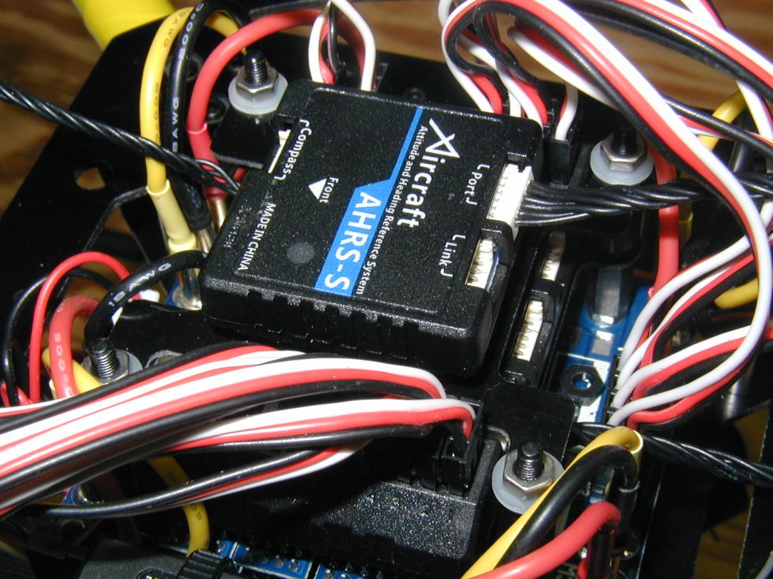

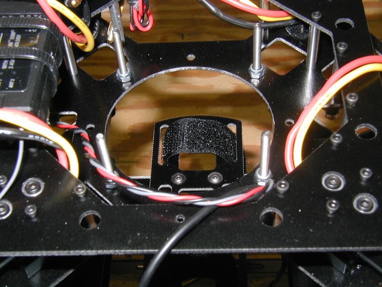

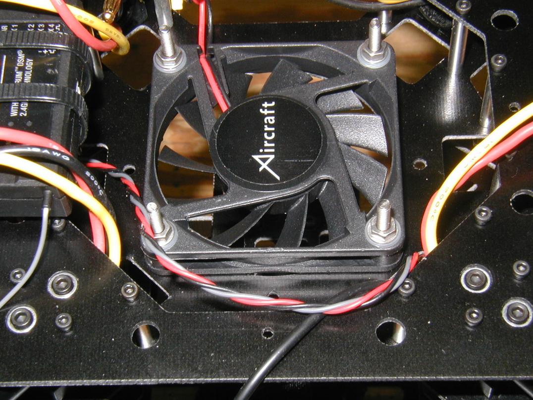

I seem to have lucked out as everything is back together and working properly. i misspoke in my previous post, it was the power distribution board that wore through the plastic studs and caused the component stack to break loose.
In rebuilding the components stack I did the following;
from underneath inserted four M3x25mm steel screws and anchored them tightly in place with 3mm nylock nuts.
installed the fan normally onto the steel studs.
put a 3mm nylon washer followed by a steel flat washer and a steel nut on each stud, using locktite on the nuts
threaded a stand-off onto each of the four exposed screw ends
installed the power distribution board and anchored it with a steel washer and steel nut (no locktite on any plastic fasteners), followed by a threaded stand-off onto each spot
installed the flight control board normally
installed the AHRSs and anchored it in place with a nylon washer and steel nut on each stud.
I saw someone mention somewhere that the AHRSs came unstuck from it's foamy double sticky tape and that got me thinking that a tape failure could cause the same crash I had yesterday so I'm going to work on finding a source for these
http://www.mcmaster.com/#spacers-and-standoffs/=b168lb
and put a brace across the top of the AHRSs to keep it from popping off the plate it's stuck to.
The pictures below show the rebuild. It's very windy otherwise I'd be outside flying instead of typing.
Bart
Bart
