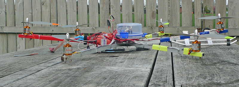

Boris, If you could when you get done with your ring could you post pictures... I'm thinking about building the same setup as you have and any and all info you wouldn't mind sharing would be beneficial... thanks
BorisS
Hi Dixter,
i am going to switch over to a product for the distribution ring. Things just get cleaner i have very short cables directly to the ESCs and the weigh will be reduce by 50 - 100 Grams.

Dixter
Thanks Boris... where do you find a " AfroPower " power distribution board... can't find it on google...
also... how do you like your new bird compared to your AD8 HLE
