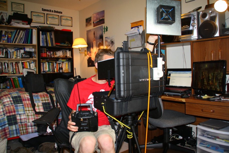

I think the easiest is whatever collapses the smallest/easiest. I have my setup mounted on a tripod with no ground station case. However, this is really a personal preference.
This is not mine, but looks very similar to what I've done.
attachment.php

No, I have no case in my setup, at all. I have my crosshair antenna with Eagle Eyes fastened on the back. I have a second receiver with cloverleaf antenna fastened on the back (just like in the above picture). Then I have a 5.8Ghz relay transmitter fastened to the back of the crosshair antenna as well. It relays the signal from the Eagle Eyes unit to my monitors. The monitors mount on a tripod easily.
This way, I can setup my ground/relay station on top of my truck, and setup my monitor tripods on the ground - and I have a great deal of flexibility in placement of these things.

Maybe groun station... as this like. Your suggestions very valuable for me..
