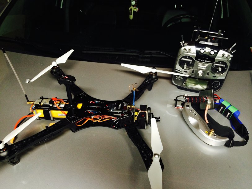

I wanted to address the 5.8GHz thing again, one last time. Today, just now, I changed my config on my quad - stuck my TS832 on it with a cloverleaf antenna. The antenna in the picture is a cheapy - I also swapped and tried it with one from VAS (IBCrazy). I was using my GS920 Boscam goggles AND a Black Pearl 7" monitor with diversity. I don't have a dedicated 5.8GHz receiver like my 1.2/1.3's from RMRC. On my goggles, as you'll see, I have a 5-turn helical antenna, which I also tried my omni's - but the 5-turn helical is much better. Again, this helical is from VAS.
I flew in a straight line - straight line of sight at around 90 to 100 meters altitude. At 2010 feet/613 meters my goggles stopped working. The video was degraded so bad I couldn't go further. Switching to the Black Pearl monitor, I could get another 40 to 50 feet away - maybe a little more. I couldn't make 1km - there's just no way.
I've read that the TS832, while it says 600mw, it's really only about 570mw. So maybe there's "some" difference there. I've just never been able to get a kilometer away with 5.8GHz. I'm guessing that if I bought a 1000mw or 2000mw 5.8GHz transmitter I "might" get there. However, that said, the 2000mw transmitters pull 800mah of power, which is a LOT, I think. Surely that would reduce flight time "some". So the only other test I'd like to do is with an IRC 600/700mw 5.8GHz with my Dominators to see if the receiver is any better, but I'm doubting it will be.
Here's the thing, you can start, just like I did and buy the transmitters, monitors and the goggles that do 5.8GHz - spend a ton of money only to discover you have a lot of limitations, or... read up and learn how to use 1.2/1.3GHz. Get yourself a 500mw 1.2GHz transmitter (hobbywireless.com - 500/1000mw 1280/1258 lawmate modified vtx), get a 1.2/1.3GHz receiver with sawtooth filter from readymaderc.com with a VAS mad mushroom antenna (with a multirotor, you'll be hard pressed to outfly the mad mushroom antenna and 1.3 - no reason for an antenna tracker) - get a UHF LRS system and don't waste the thousands of dollars stepping up into this setup. You should definitely start with a smaller multirotor and a GoPro, but just make sure that what you buy to start with, isn't going to be a waste later on.

So what fc you using in that quad and what quad is that?
dtw
KC1UAV
That's a Neewer Special! Seriously, it's a cheap cheap frame from Amazon that I bought because I thought it looked kind of cool (http://www.amazon.com/gp/product/B00LAPUAI6/ref=oh_aui_detailpage_o00_s00?ie=UTF8&psc=1) and I have a bunch of spare black DJI arms that I figured I could use if I crashed it.
The motors are spare motors I bought for my F550, so they're just 2212 920kv motors from the DJI E300 set. However, I changed the props to 9450's instead of the stock 9443's - which the jury is still out on that, although today when I was flying, they did seem to scoot a bit faster.
The controller is an Eagle Tree Vector, which I do like because the fc, osd, and lc filter are all rolled up into a small box that's lighter weight than the Naza Lite controller by itself. It was easy to install and setup, but I've been tweaking it slowly to dial it in. I really like the OSD and configuration menus within the OSD - makes configuring the gains and PID settings super easy.
That's also the newest DragonLink receiver in the back. It's very lightweight, and 100% configurable with S.bus, PPM, digital and analog RSSI, 12 channel and 8 pins for external connectors. Has a built-in simple spectrum analyzer and very nice features if you're not familiar.
I typically have it setup with a 10g 200mw 2.4GHz transmitter, but lately I've had bad luck with that setup - I have a pair of Dominators being delivered tomorrow with the 2.4GHz module and the 700mw IRC 2.4GHz transmitter. Should give me much better range. Basically, it's just for messing around or testing, as I did today...
