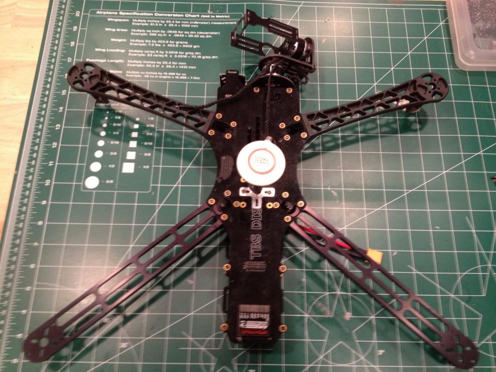

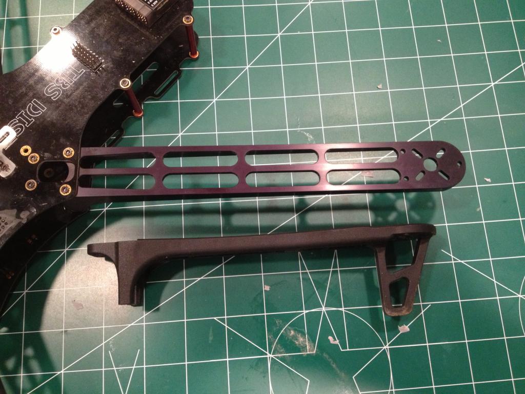

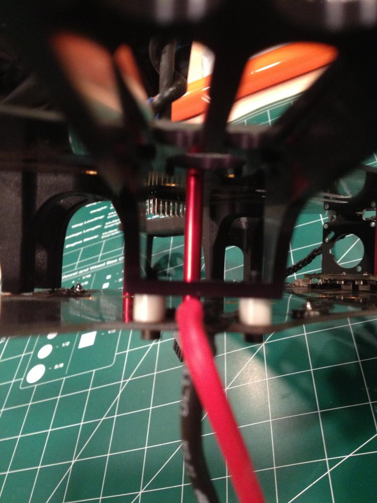

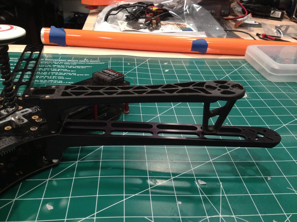

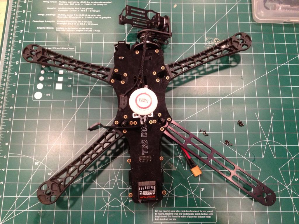

These are the AIMDROIX Aluminum arms on the TBS disco. (thanks to Eric FPV for the pictures)
View attachment 13796 View attachment 13798 View attachment 13799 View attachment 13800
As aluminum is very good material for heat dissipation, the heat generated by the motors will be conducted to the arm. You'll notice how cool your motors will be, even after flying for more than 15 min in a 85F weather. This will extend the life of your motors and also will improve the efficiency as they will operate at a lower temperature.
I'm currently working on an extensive analysis to know how much heat is actually being dissipated by the arm. I'm taking this as a project on my Heat transfer class, but basically, your motor in attached to a decent size heat sink. Hopefully, we'll provide the final results in the next month or two.
You are not just buying a cnc aluminum piece, there is a lot of engineering involve in the design and all of our products will be done the same way.
Here you can see how the spacers will allow to connect the battery to the tbs battery tabs.
