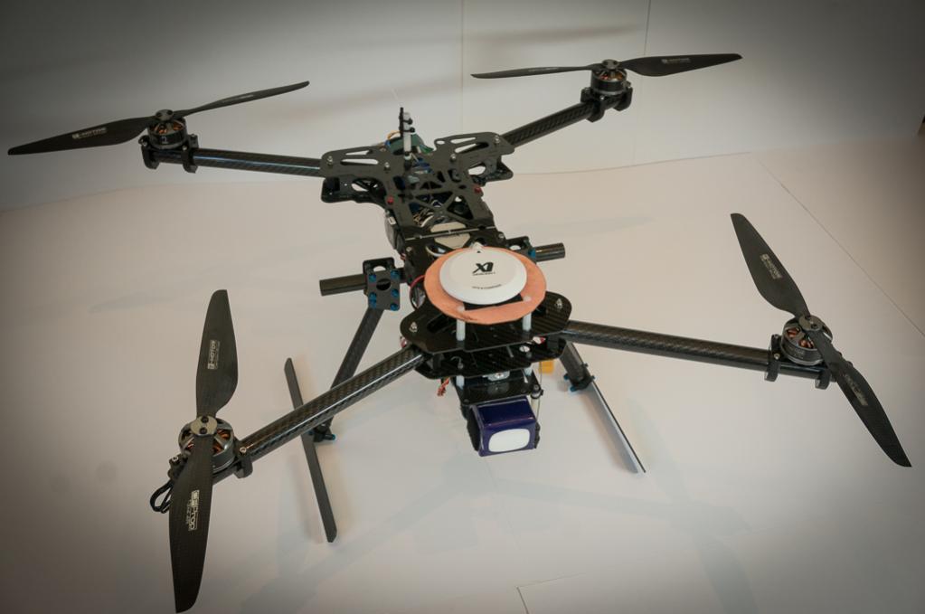

Last week, I posted about the new quad I'm working on and that it wobbled quite a bit. In the meantime, I made a few changes and it's flying well now. At first, I thought the wobbles had to do with the FPV style layout because others have reported problems with this layout. But it was mostly the gains. Once I turned them down, the wobbles changed to twitches and then go away completely. They are now at 0.6, 0.6, 0.7, 0.7 with the gain knob at 20%. I also backed down the gains on my Y6 from 1.0 to 0.8 and I think it flies better now, smoother and less rigid. Better for taking video.
While the quad fly nicely, it still feels more docile than my Y6-SuperX or my smaller Naza quads. Not sure if this has to do with the 'bigger' 13" props, arm length, the motors, the ESCs, the AUW or a combination of these. I'm currently using T-motor MN3510-13 700kv and Tiger CF 13x4.4 inch props. It hovers below 60% with a current weight of 2.8kg (this includes some dead weight to simulate the camera). Final weight will be 3.6kg with a RX100 III, 3-axis gimbal and around 900g of battery. For this weight I will switch to KDE 3510 motors, 13-14" props and either KDE or Castle ESCs.

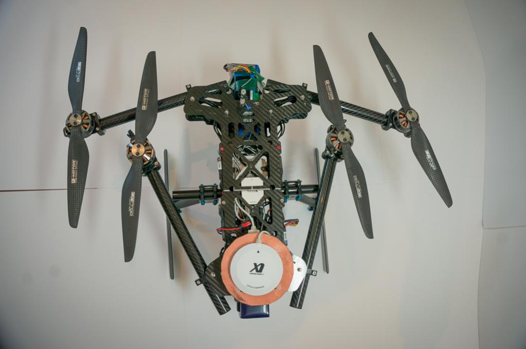

Here are a few pictures of this quad. It's a 690 size foldable frame from Germany, the Black Snapper (basically unknown in the US). The arms can be put into different positions for an asymmetric or a more symmetric configuration. My motors are now almost symmetrical. The lateral distance is 20 inches (same front and back). The distance between front and back is shorter by 5/4 inches. The nice thing about this frame is that you can neatly fold it for transport.

Agree. I'd like to see a side view in the folded position, and like to know what the folded dimensions are.
Picture #4 is the side view, folded. The legs are not the original ones, I added them on my own so I can adjust them to whatever the gimbal needs. But I hope it won't be any higher. Btw. arms are 20mm tubes. So far the folding mechanism looks solid to me. I have not seen anyone having problems with them during flight. Part of the reason, I chose the German frame over a Chinese knockoff.
Without props, it's 16x10.5", with 13" props the length is 17 3/4". Height without landing gear and gimbal is 4 3/4". Would be great with folding props, then the prop size does not increase the length.
For transportation I have two options. #1, just fold the arms. Then it takes up less space in my car and it is easy to carry around. #2, for traveling, I can take of the landing gear and gimbal and it will fit into a carry on case. That was my main intention when building this frame. With the RX100, it would be big step up from a GoPro copter (e.g. Phantom) but still in a small form factor.
