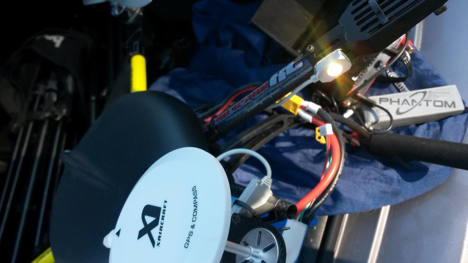

Ok i am still having problem with the gps mode i change the gps and i still get a green solid green lite which i can't take of that way motor will not start only way is to put on att and take of and put to gps and that green led stay solid. Not sure if it the receiver it a futaba or the con troll box any one have any idea?View attachment 15533View attachment 15534View attachment 15535

Ok i am still having problem with the gps mode i change the gps and i still get a green solid green lite which i can't take of that way motor will not start only way is to put on att and take of and put to gps and that green led stay solid. Not sure if it the receiver it a futaba or the con troll box any one have any idea?View attachment 19414View attachment 19415View attachment 19416
It may be just me, but that looks like the solid YELLOW LED (which almost looks like a pale green). Did you calibrate your compass properly? Even your description of the problem sounds like it's the yellow led of an uncalibrated compass. The reason I say this is there is only one solid color mode - yellow. All other modes flash. When you switch to ATT mode, the LED should flash green. Is it a different green than the solid one you are seeing?

Yes this brand new GPS DAVID I did calibrated several time when indoors it blink red and green that means no gps i think well i am getting a frsky trannis by thursday let me try that radio with new receiver maybe that will fix it!.
There's your answer. You cannot calibrate the compass while indoors. It MUST be calibrated while outside. And away from metal objects and building if possible. Also try to calibrate while away from any power sources. Here is the latest manual. Check page 17 on calibrating the compass.

Thanks Zirt57 it was out side i calibrate the compass some time i fly indoor so i swicth to gps se what i get i get red and green clinking lights but when i take it out door it get green in 1 min or more soon as it locate a gps .
Dhardjono
Walk to the window and gps goes solid green or yellow
indoors i can fly in gps it blink red and green i bring the copter to a window it goes solid green or yellow i am little color blind and will not be able to start motor. Any other suggestion maybe i should re installed the latest firm ware?

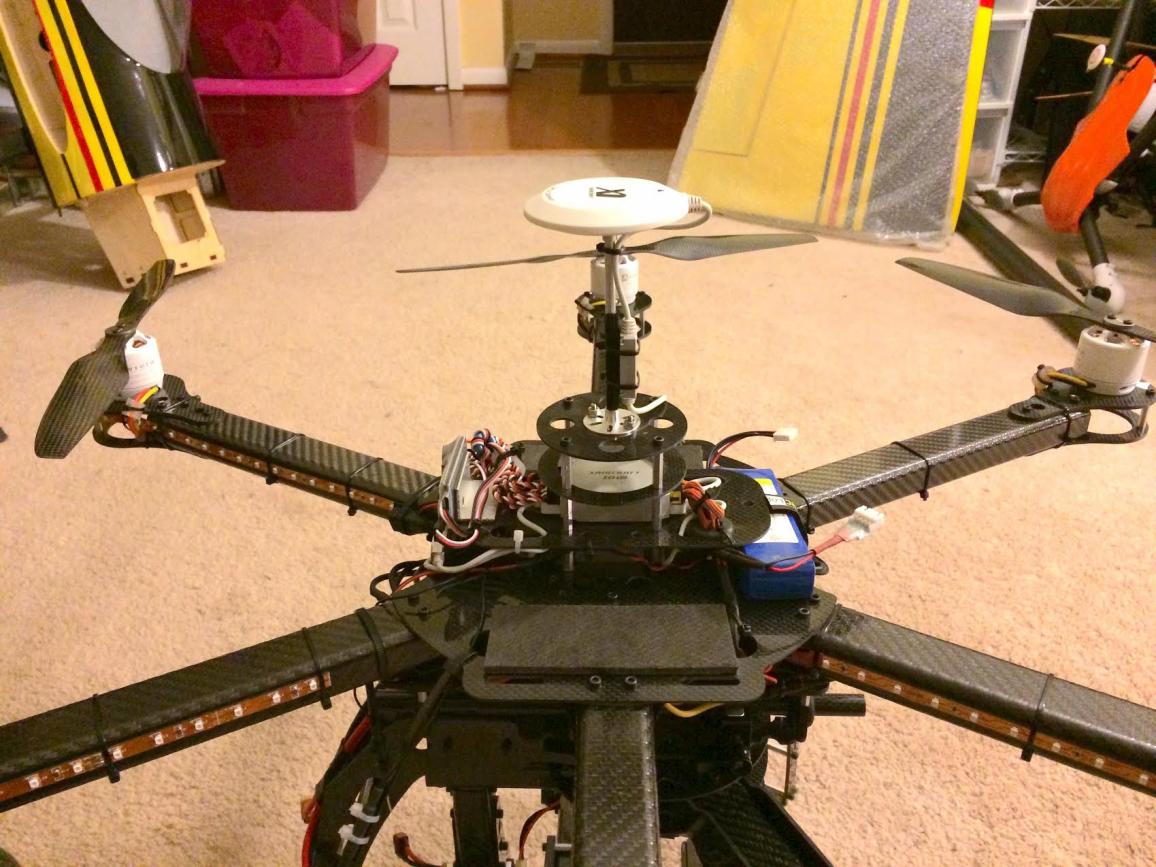

Ok David thanks for thelink got it to fly. ok no more now on topic you think the pedal aluminum is causing the gps to go crazy?View attachment 15559 as you see on that aluminum i will take it off and try on regular way.
Dhardjono
I think i got the GPS to work
:nevreness: i took out the aluminum rod and stuck it on the plate and went out doors in back of my building first thing i notice no solid greenish yellowish light it was blinking red and green so that means searching for gps i calibrate again and flew it but it still did not pick up any gps because it l;like on attitude it could be the tall building in this alley way. So ether that rod or the trannis radio that fix it, Hoping to try in open field :tennis: ok thanks David and all.View attachment 15560
