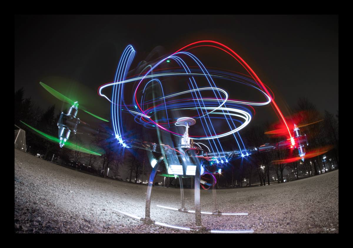

karri3nen
I just looove my Y6 just with SuperX, It will be my weapon when shooting with Hero3. But it is just most fun flying thing I´ve had!
We gonna make some presentation video Our all Y6, X8, Hexa With brushless gimbals and SuperX later from Dark FInland:) . Here just for see how mine Y6 flies in attimode with led´s:
I have here Flyduino HL XL frame and Hobbyking electric´s.
Just a question about esc´s?
I Learned flashing my esc´s and Hobbyking Blueseries 40A works just great with SimonK here .
I am anyway new in flashing.
So Do anyone have experience or is it possible to flash esc´s to Ultra PWM or what it was :/ ? Do I benefit flashing esc´s to something else than SimonK with SuperX and is it possible?
Thanks if someone have link some tutorial-videos?If possible. Now X8 night :)! Br, karri3nen
