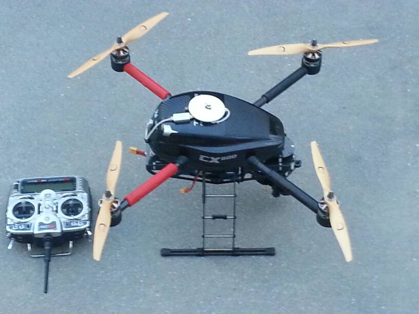

Un-fkn-believable performance tonight. So smooth in manual ATT as there was zero wind. I threw on some Xoar 12x5's I had from my XM6 and it seemed to make my quad 50% quieter. Control felt so attached and connected, as if it was hard wired to my transmitter. Not so much as twitch.
