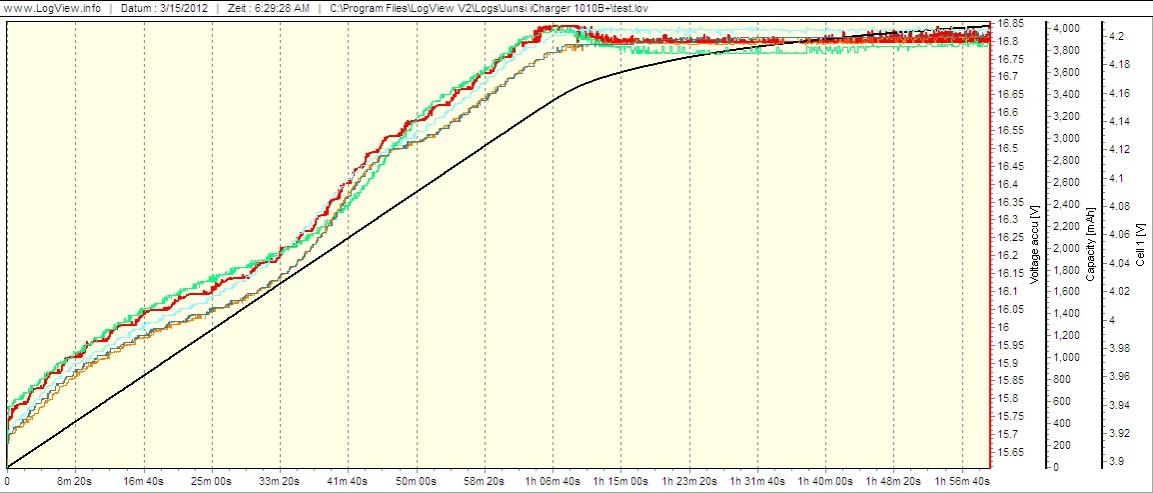

by the way the lipo is coming along good, just charged them from 3.8* volt and got in 4000 mAh, just discharging them and montoring again, than i will put them to the practical test, logging data again
