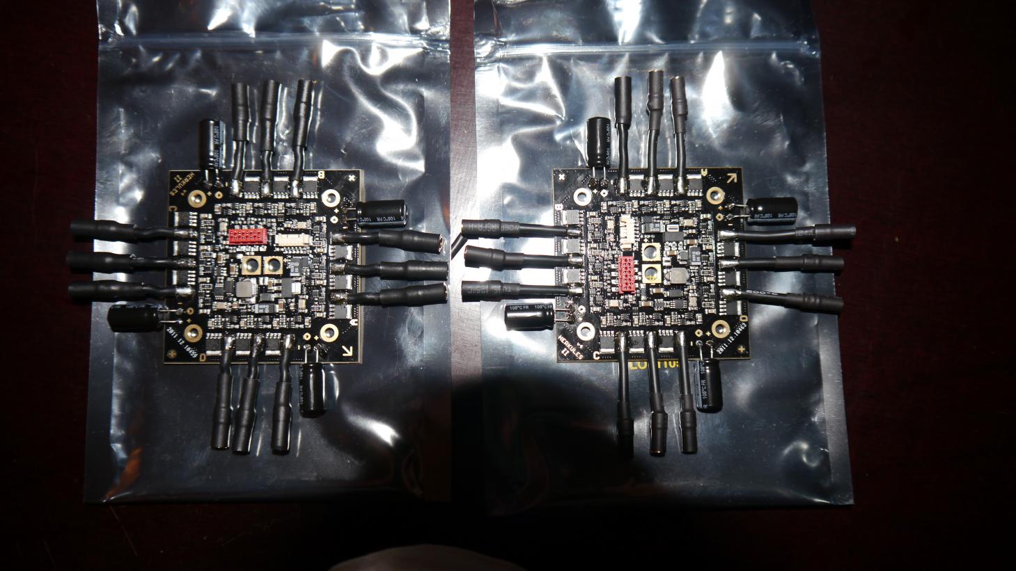

I just finished up two today. For me the benefits are also that it has an independant firmware and one doesnt have to wait or aks MK H&I to change something !

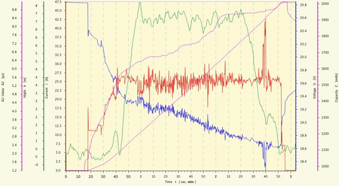

one of my temp logs, Value A2 is temp max 8 degress, 5.5 kg octo flying, but outside temps were around 0

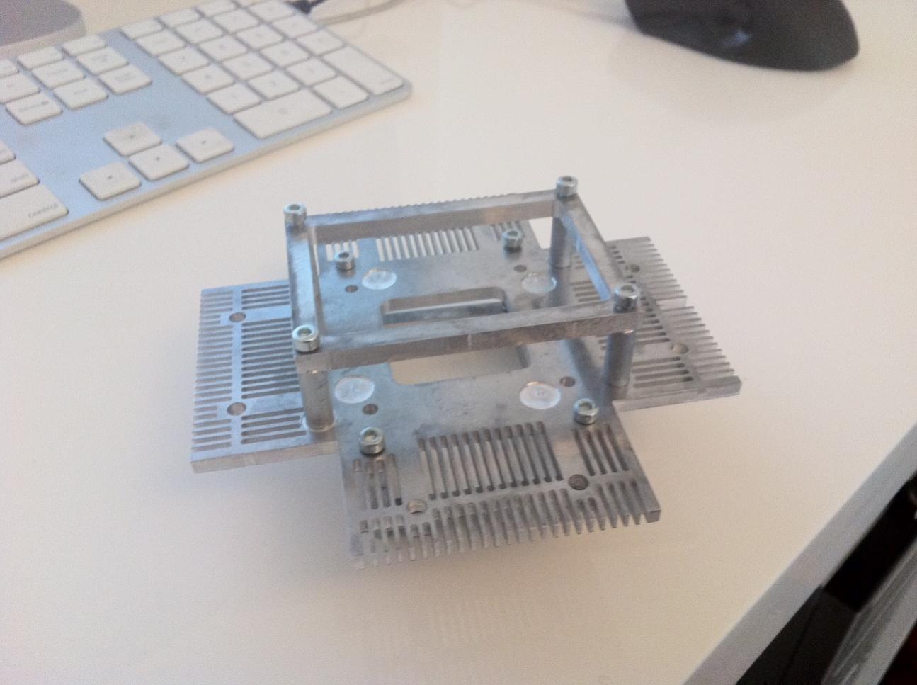

And they are selling coolers with it fitting DW frames:
http://www.globe-flight.de/Herkules-II-Kuehlkoerper-X-Okto

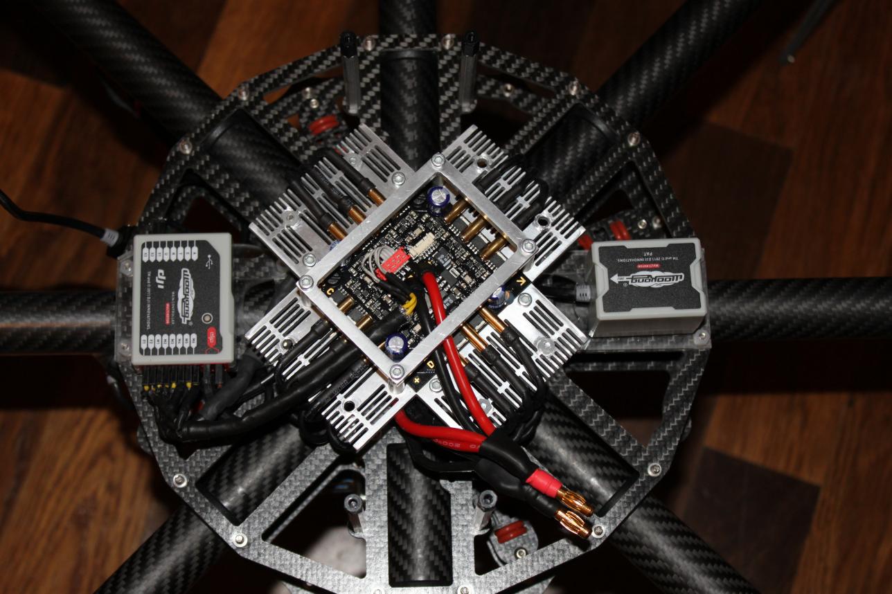

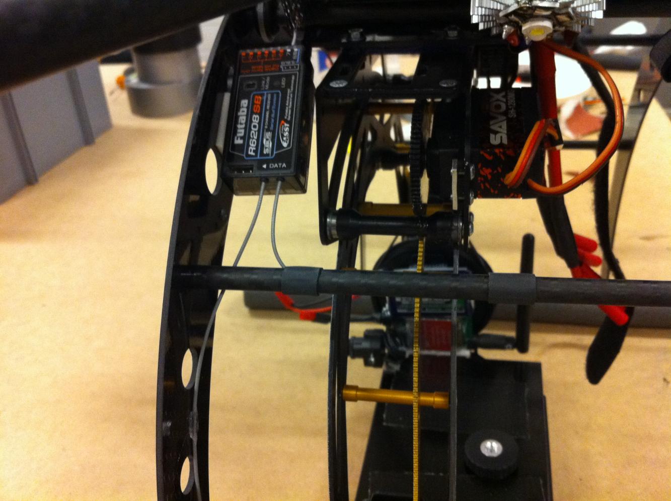

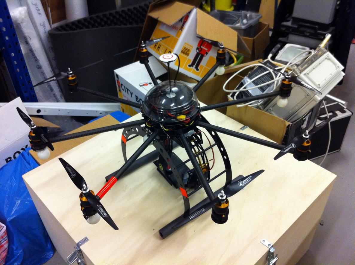

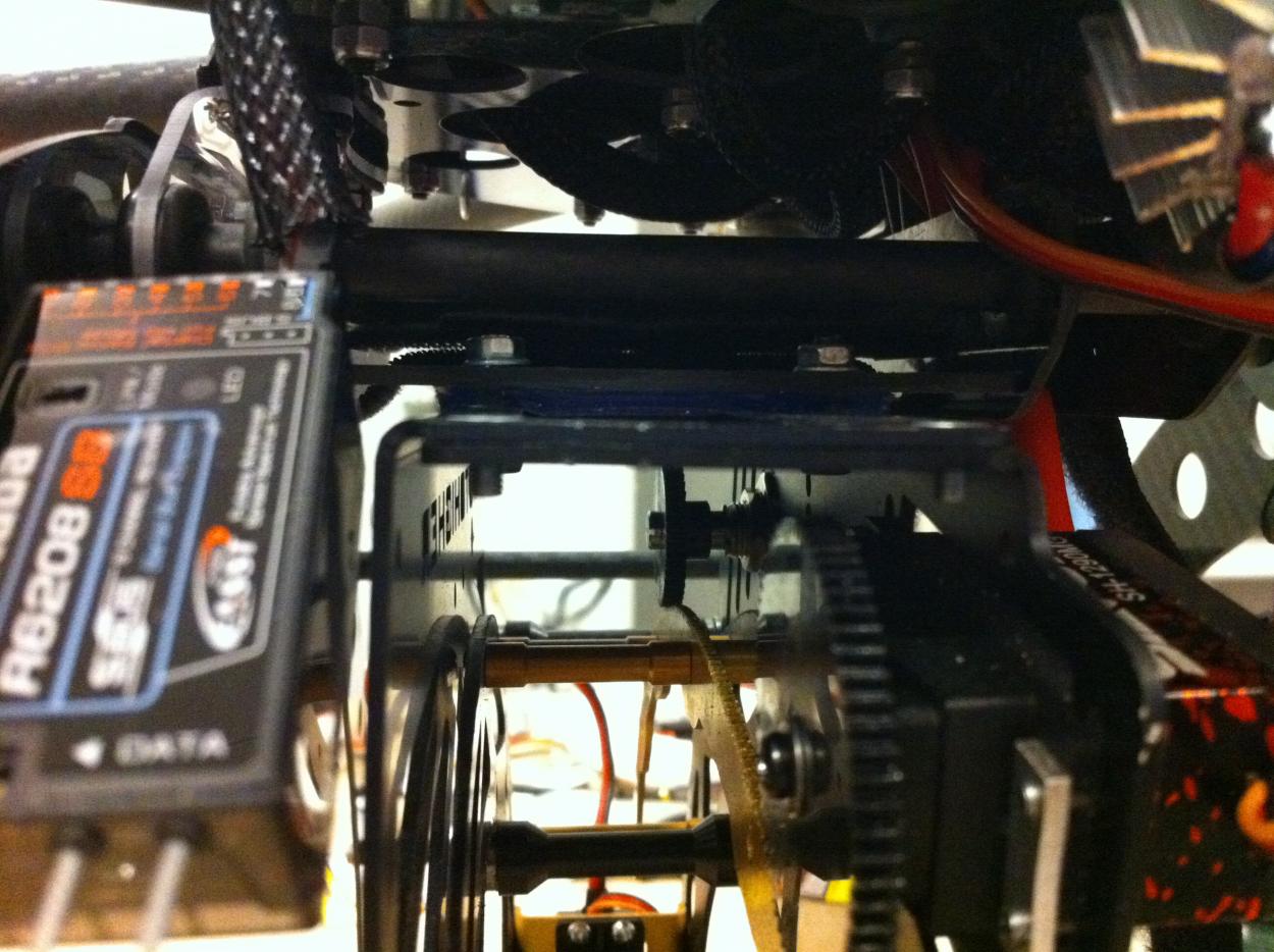

I am using WKM with the hercs, but several others are using them with MK. FC and Navi added to it is no problem, with an OSD it might be an issue. But i personally wouldnt add an OSD setup to a Dedicated AV HL plattform but thats a question of taste. One more thing concerning the Herc WKM combo there are little issue at the moment, if you follow the Herkules CS8 build thread and some off use with bigger props on the setup are experiencing power surges, but that will be resolved. At the moment not such an issue because WKM with bigger and heavier props is not really giving the best performance anyways.
Thats the way i am using them with a custom cooler :
View attachment 2445View attachment 2446View attachment 2447

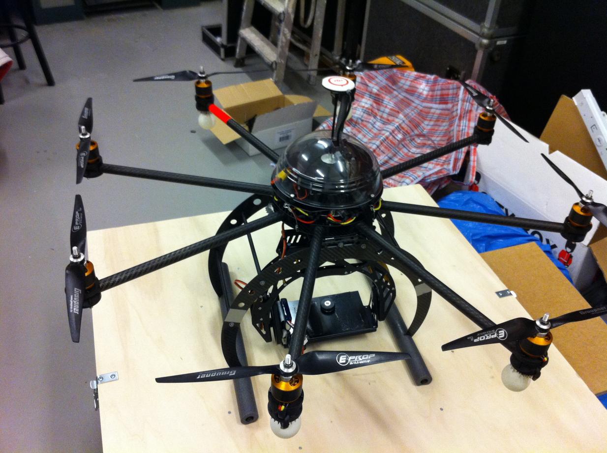

Axi 4120/20 and currently 2x 5000mah 5S, this baby going to lift lots :) However currently flight times are suffering so we'll go to 8000mah bats and most likely 15x4" props (currently 14x8 graupner). Possibly even go to 6S.
elossam
Boris do you have an idea about what and how Imu, mixer board and ESC interact to each other in therms of rf noise. Can see you heve the three elements in line instead of one over the other like most other setups. Is the IMU radiating over the mixer board? Maybe the escs is the guily guy here?
