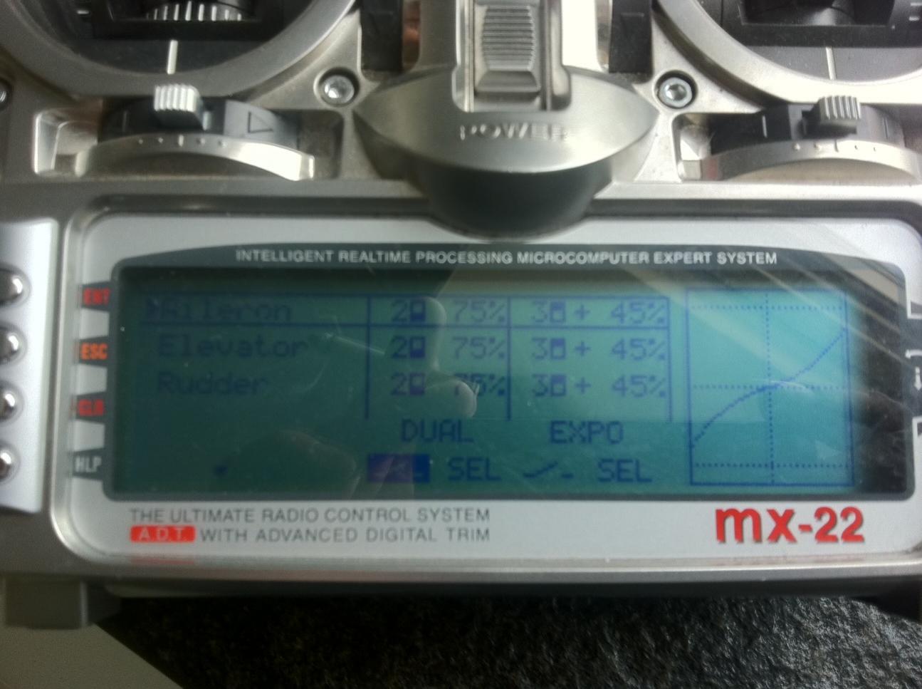

I have my basic gain around 100 and atti gains down to 40%... It is still very reactive to the stick movement of my MX-20,,, maybe someone can tell me how to deal with that!?
BorisS
Cine, setup some Expo and dual rate on your MX 20. I have 75 on dual rate and 40 % on 4 expo. Giving me a curve like this:
Best is to program is onto switches that for take off and lading i can deactivate expo and dual rate for faster reaction again.

Thanx Boriss,
I am gonna try that in the coming weeks... how about my ESC's? should i just live them with factory settings???
