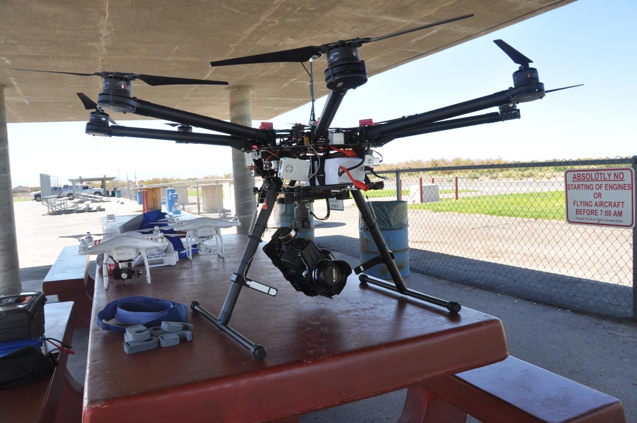

Some pictures from todays flying.
attachment.php
attachment.php
attachment.php
Quinton
Looks good.
Is it possible you can give the all up weight of it ready to fly with and without lipos including the BMPCC?
I see you have an extended antennae on both legs, I can see a lightbridge on there, what is the other one?
Tahoe Ed
Looks good.
It is 16 pounds with the lipos and the lipos weight 4 pounds so 12#'s or about 5.5kg.
Quinton
OK great thanks, so even with a couple of 5200 mAh lipos on there it could be below 7KG
What all have you got on there, I take it is the A2, is that including the lightbridge and do you have anything else?

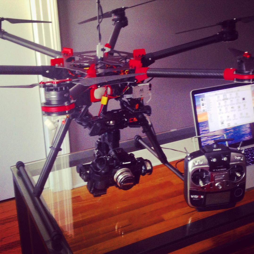

Got mine all dialed up! Only issue I really see is the landing legs are way too short and you need to have something under the unit for the zenmuse to calibrate and not sack the ground.
Have a few flights but will give a full report once I get some more time in the sky. Will be testing a a few batteries ranging from a 10,000 up to a 16,000. Have a look at the setup thus far:
attachment.php
Thats probably because you are not using the NEW GH3/4 Gimbal that does NOT rotate the camera 360º in pitch to calibrate. What do you expect from them. You must buy the latest Gimbal four the latest frame!
