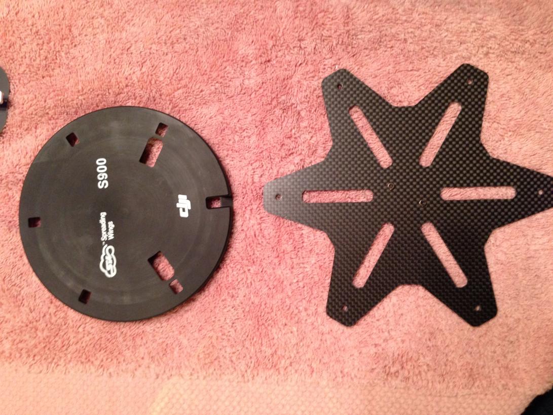

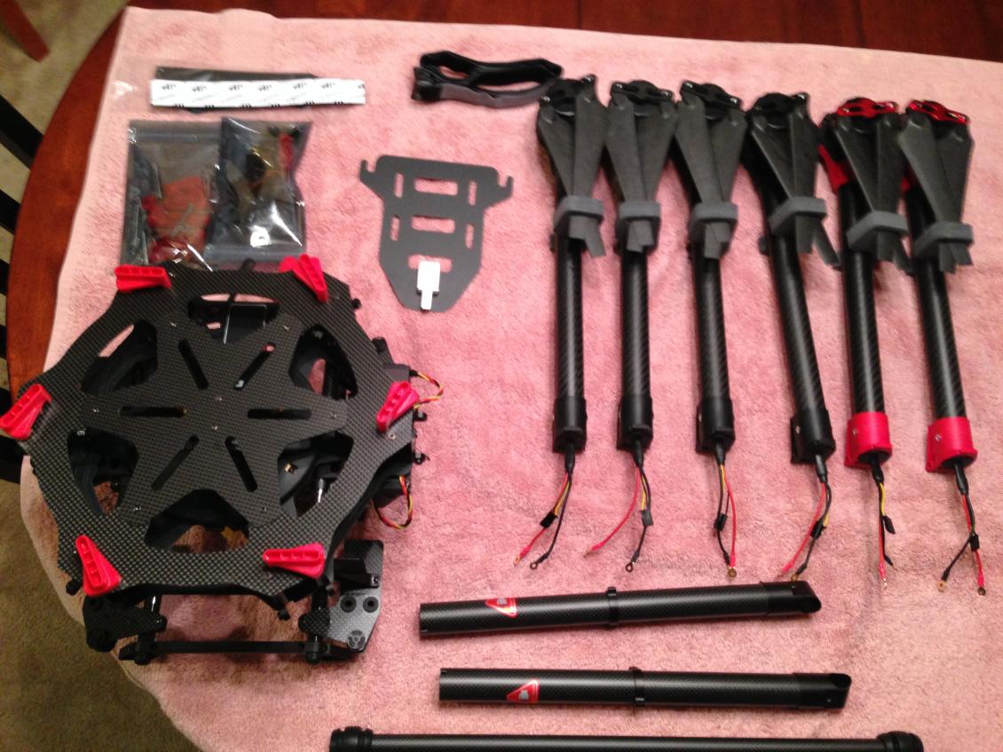

The build continues.
attachment.php
Top plate and cover.
attachment.php
ESC connectors
attachment.php
Included parts
attachment.php
Composite motor mount
attachment.php
Composite arm mount
attachment.php
ESC's connected - Be careful when putting the cap back on not to pinch the wires.
attachment.php

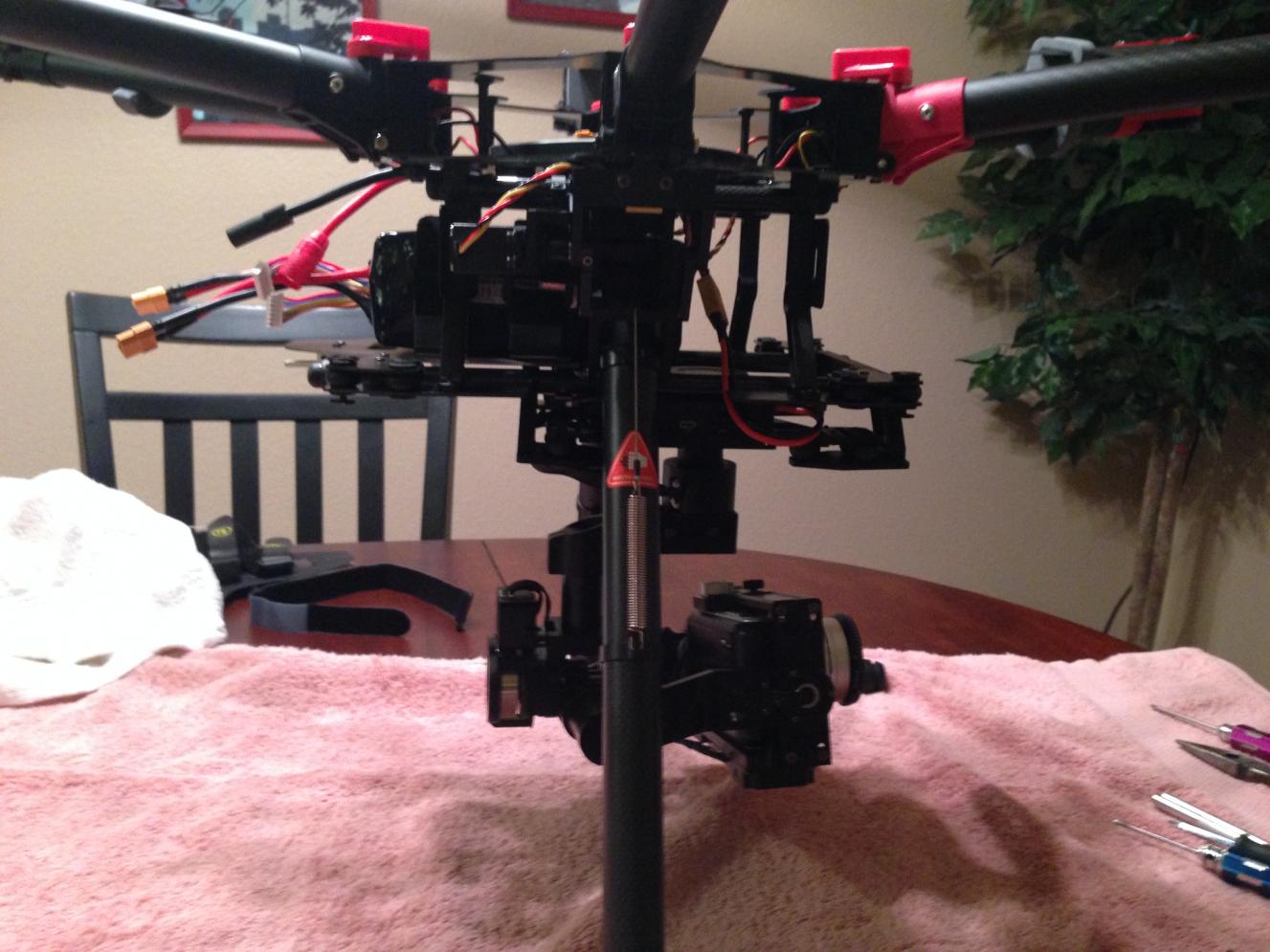

Zen for BMPCC mounted
attachment.php
Balanced with 2x6000mAh lipos

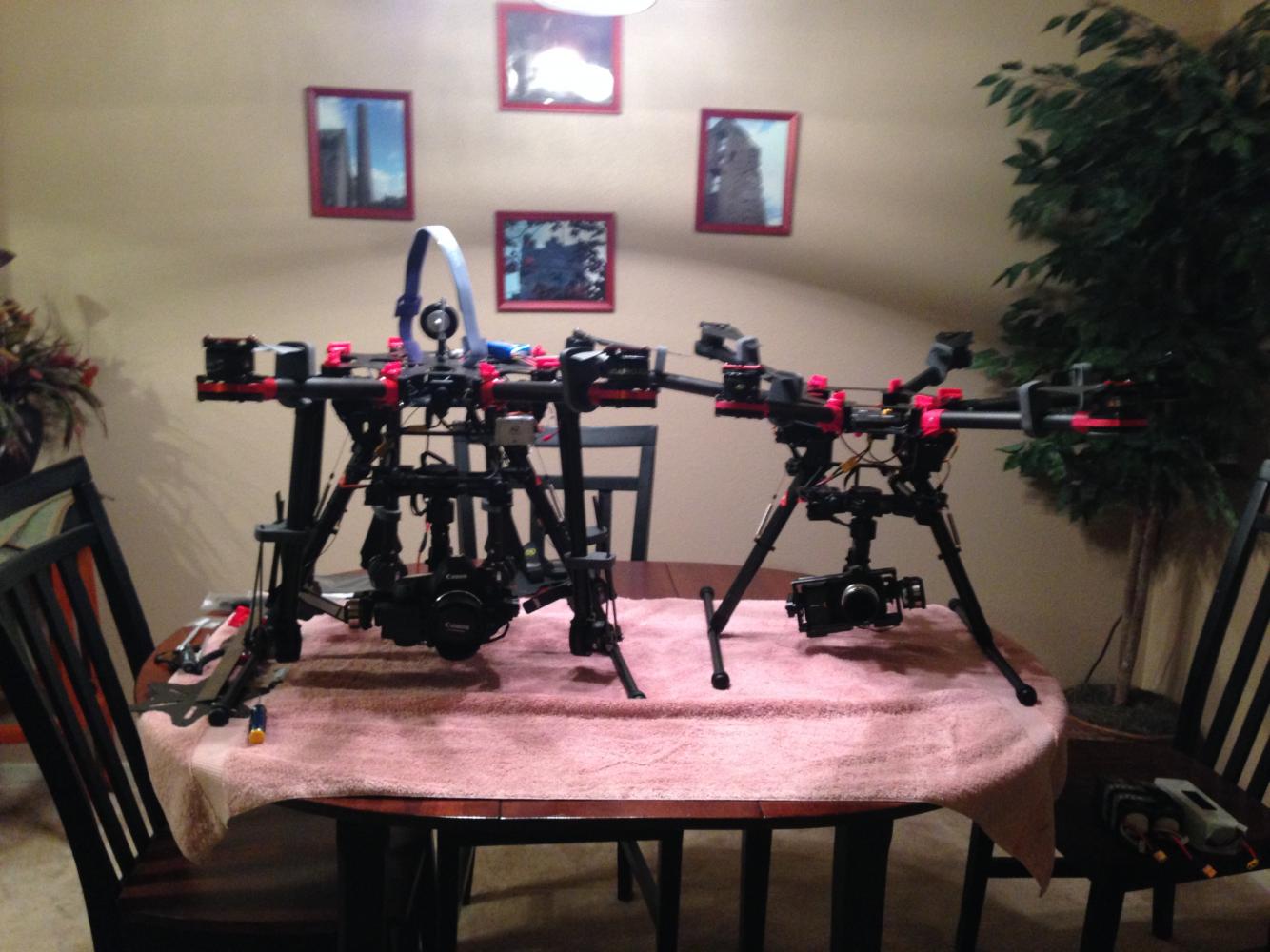

This a comparison of the S1000 and S900. The S1000 is 45cm tall vs the S900 at 41cm. The landing gear is 56cm vs 41.5cm. I have not weighed the S900 yet. I still have to install the electronics. I should have that tomorrow. Then time to set up the Lightbridge, the A2 and I am going to solder the connectors on a 10000mAh lipo that I have.

soler
It would be interesting to see a few more detailed pictures of the S900 V S1000, it seams the S900 has plastic boom holders, why else is different

Build notes:
- Inorder to mount the gimbal I had to move the front support bar back 10mm. Even with that it is a tight fit. I would like to see the rails a little longer but that is a quick fix.
- To balance the craft I had to move the lipos forward about 60mm. I am going to move the lipo plate mounts so the batteries can be centered on the plate. It makes for a very compact installation.
- Be very careful when installing the cover over the esc leads. I nicked one lead in doing so. A little liquid tape took care of that. It is tight.
- I like the removable center plate. The mounting of the electronics should be very straight forward. I have ordered a second set of Lightbridge antenna extenders and paddle antenna mounts for the retracts.
I will be mounting the electronics today and creating a charging lead.
