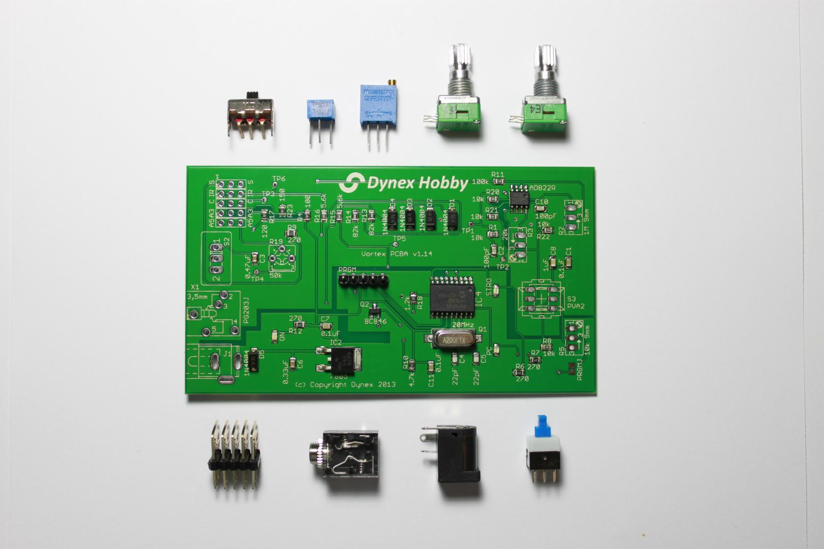

Hi Chris, this balancing system is interesting, seems very good and well priced, did you receive it in bits and have to assemble (seems like it is a kit) or is it a completed assembled dynamic balancing unit?
Thanks Chris - regards bruce
It comes as a kit, but with very basic soldering skills it's built up in not even 15 minutes......
This picture shows the components:
....and here you see how it looks like assembled:
After that just slide it into the casing and you are finished.
Chris
