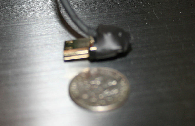

Smallest mini hdmi plug? :)
For those who are want to use the pancake lens .... I could not find any mini hdmi 90degree plug or adapter that's small enough. So you have to get the HyperThin cable and slice the rubber casing and metal casing off, cut or unsolder ground wire... re shrink it... now 1/3 of stock size. Fit with spare space left.

Cool, I'm having to do the same thing for a shutter control on my GH2, also right-angle but sticks out too much.
that re-wiring seems prone to problems, why not just build the gimbal a little wider..?????
Would this do the trick ? I never saw it anywhere else, and thought maybe you missed it.....?
http://www.globe-flight.de/bilder/produkte/gross/FPV-HDMI-Konverter.jpg
http://www.globe-flight.de/HDMI-FPV-Converter
