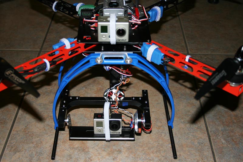

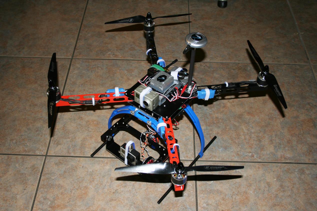

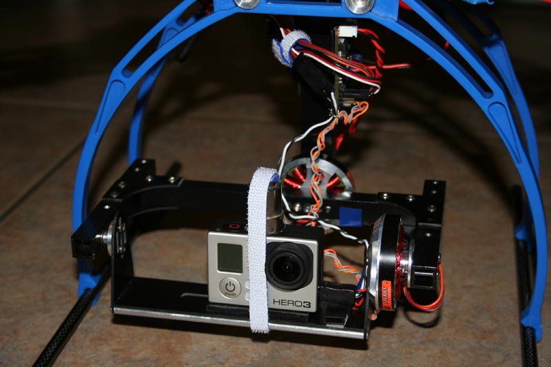

Here my brushless gimbal, initially it was make to fit anything from a GoPro to even my DSLR EOS. But turn out that might not be the efficient way of doing this. Yes, I know the motors HUGE for the GoPro use, but oh well. :)
FC: YS-X6 of course
ESC: Ipeaka 40A Simon K version
Motors: I power 2814-610kv
Gimbal Controller: SimpleBGC from Alex M.
Motor: IPower 4006 (360kv) rewound to maybe 10kv? don't know, but it's really slow. Star winding, 130T with .22mm on for Roll, 150T of .17mm wire for tilt. Purposely wounded it different to see what it does. Tilt for sure have more torque.
Yadi ya da... how about some pictures and video? Video player super smooth on my comp doesn't lag, put it on youtube and it sucks. Not sure if it have anything to do with codec. Any one know what's the best file type for youtube?

Yes. I hate the gopro lens too. But this is the best camera I have now since I smoked my Sanyo.
VERY nice results! We're researching whether it's possible to scale this system up to DSLR / RED size, would be a killer setup for sure.
I shall be able to tell you in a couple of week, working on one right now.
Nice!!! What's that silver thing on top of your gp3?
That's the counter weight, because I want the camera lens to be dead center with axis also CG is center, I had to add the weight. I think partial why it work so well is because it's 99% balance.
