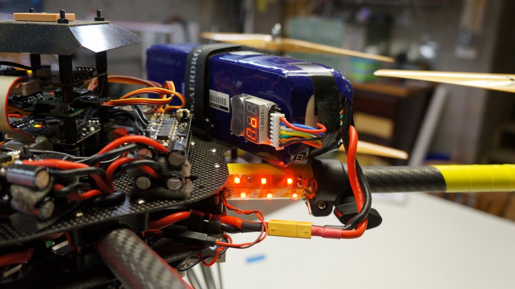

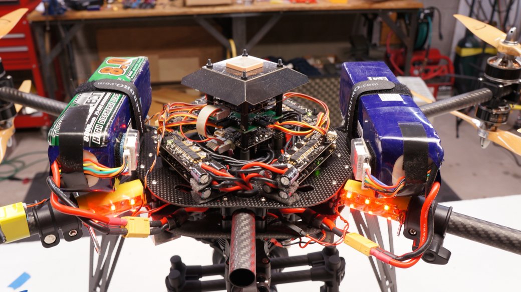

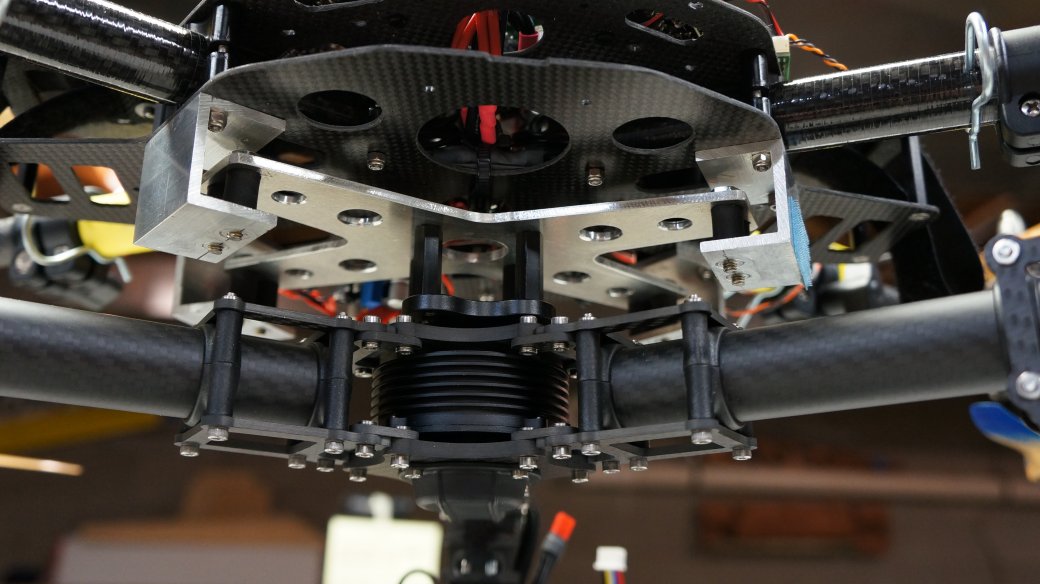

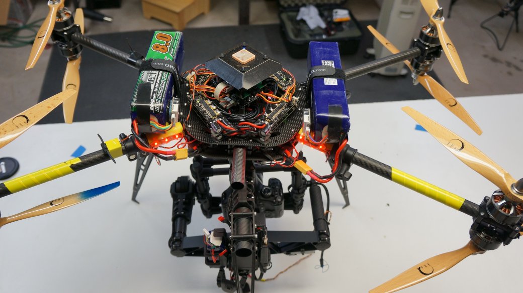

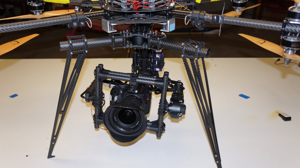

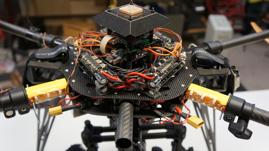

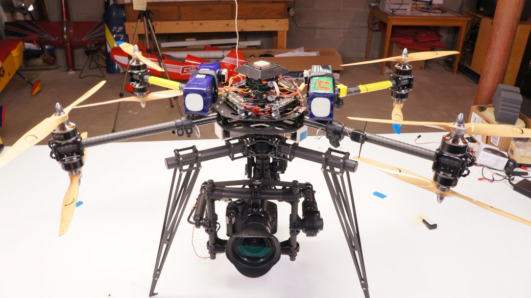

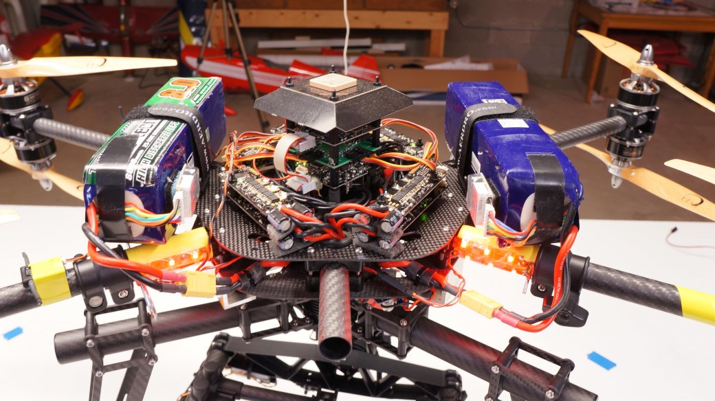

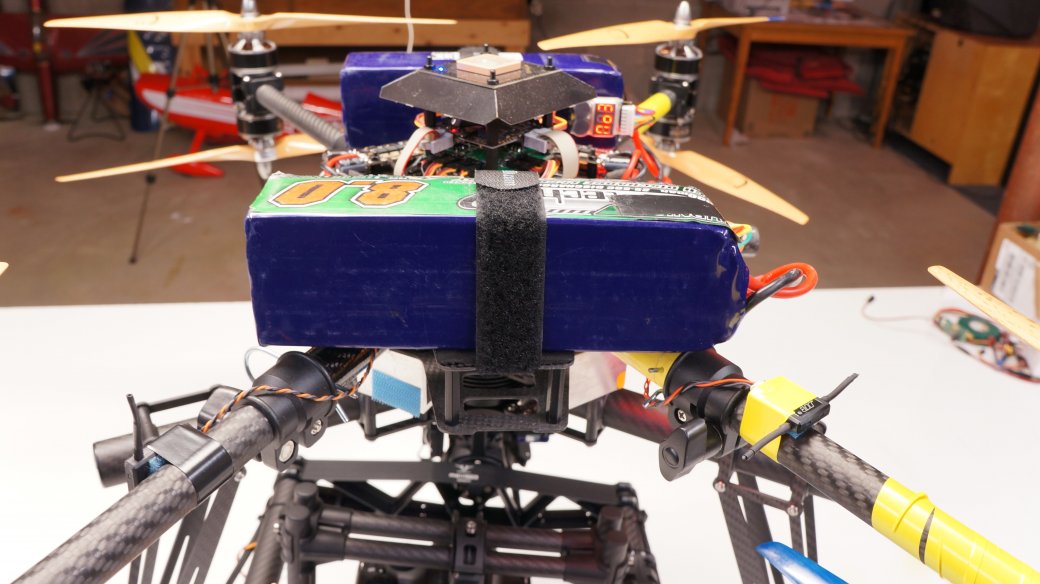

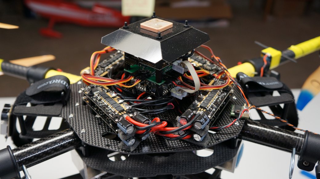

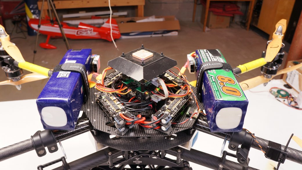

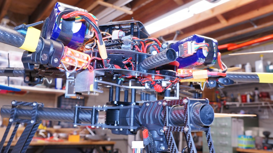

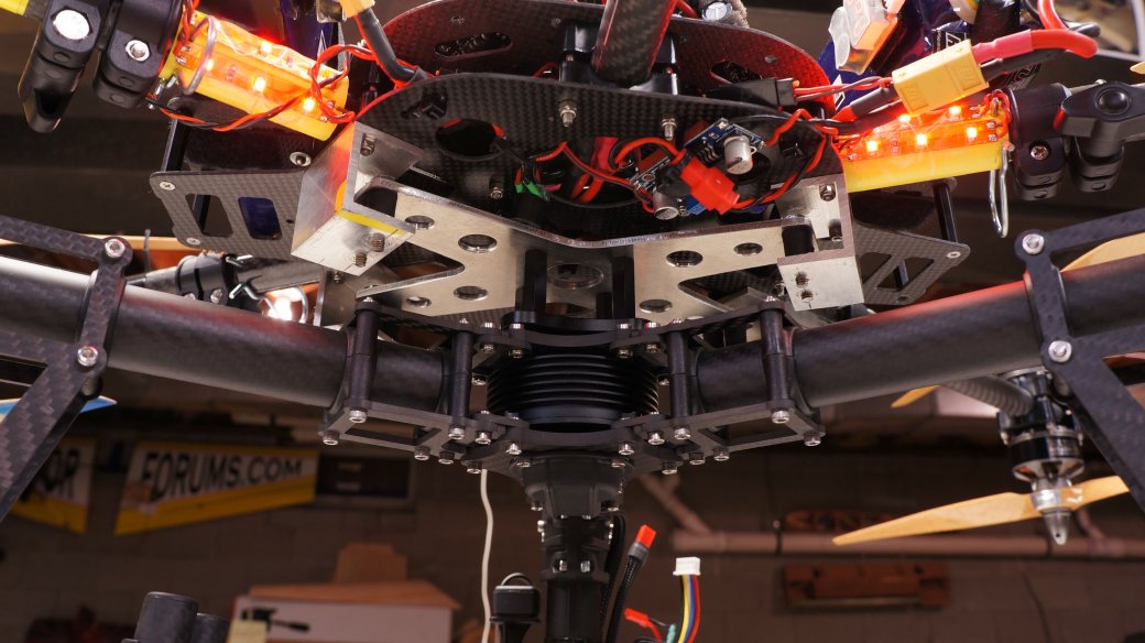

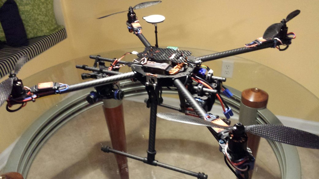

Some photos of the completed build. The custom Mōvi mount (the bare aluminum parts) is a little rough so I'll be cleaning that up a bit while the Mōvi goes out for service to replace a wire I broke after doing a firmware update. The pictures are a little crappy because I grabbed my daughter's camera to keep my Canon on the gimbal while I took photos!
View attachment 23385 View attachment 23367 View attachment 23368View attachment 23384 View attachment 23372
Batteries sit on the ears located on each side of the frame. Connections are easy to reach at the back of the frame.
View attachment 23374 View attachment 23375 View attachment 23376 View attachment 23377

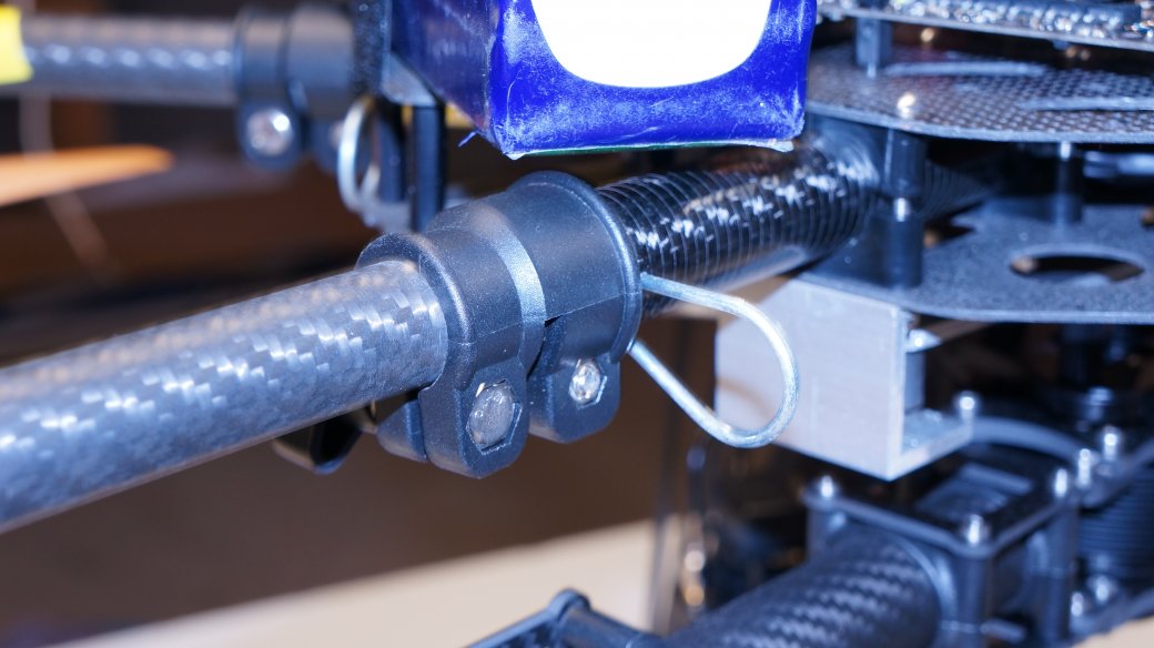

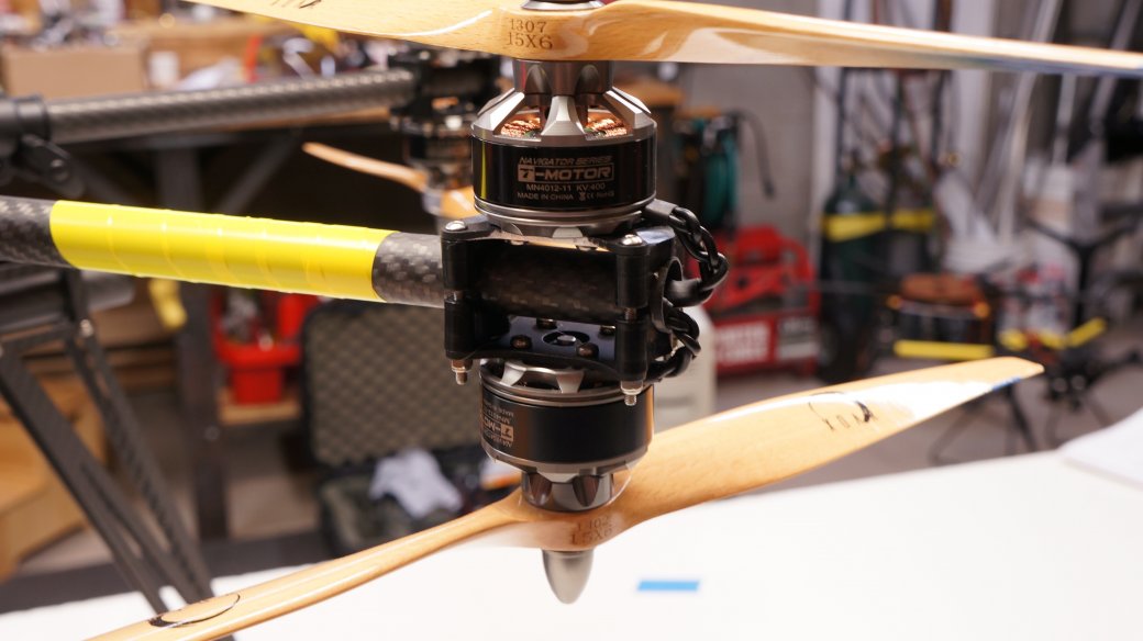

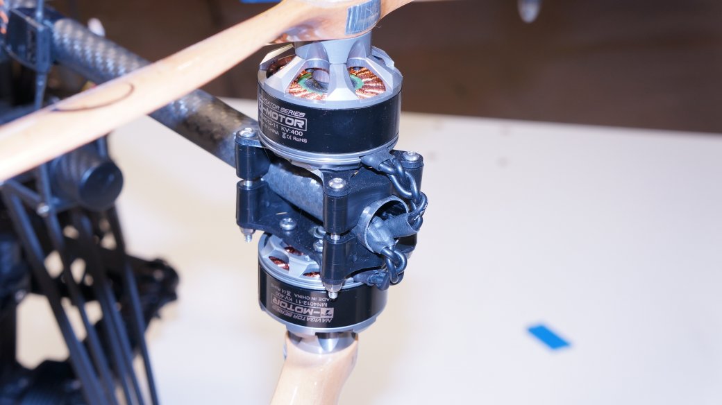

Motors are mounted using traditional clamps and motor mounting plates. The clamps are injection molded nylon and the motor mounting plates are aluminum. The arms use two telescoping tubes with a clamp so that the overall size can be shrunk down for easier travel.
View attachment 23378View attachment 23379 View attachment 23380View attachment 23373
Three views of the frame (front/side/back)
View attachment 23381 View attachment 23382 View attachment 23383

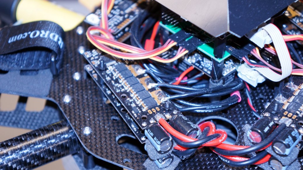

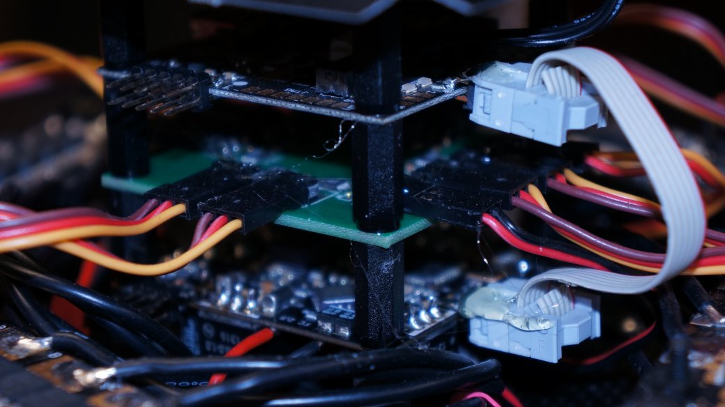

Mikrokopter makes their own motor speed controllers, called BL's for BrushLess controllers. You can either wire them into a common board that includes power distribution and I2c circuitry or you can wire them individually as I did and use an I2c isolation board (not available anymore). The I2c isolation board is the green board in the center of the electronics stack. Normally and I2c control stream would flow over two wires with a stop at each controller. The isolation board breaks up the I2c stream into individual hardwired outputs making it easier to wire and (supposedly) preventing a bad BL from corrupting the I2c stream.
View attachment 23371 View attachment 23369 View attachment 23370

Looks like you are big on wood props. I don't own any nor have I tried them. Since I started researching and learning it seems all the guys are saying Tmotor CF are the only choice. They drill this in so much I was starting to think they were the only good choice.
SleepyC
www.AirHeadMedia.com
you look much younger in video than in your picture :)
They are, wood warp and change with humidity. Bart just owns like 22,000 pairs of them so he is still using them. :D
that's incorrect Sleepy, wood that is sealed properly doesn't warp or change with humidity. wood does naturally dampen vibrations though and it splits and shatters dissipating energy as it does keeping the motors from being damaged in crashes.
