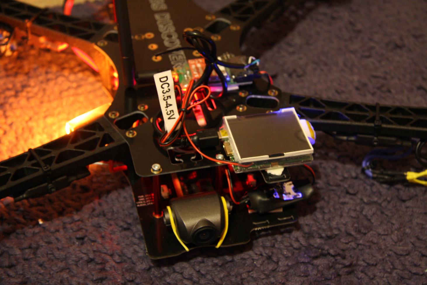

just got back the disco maiden, vids uploading. shes got mad power but flies alot different than my kloners, probably motor related. super fast, but altitude is super weak from what i'm used, never have pushed the sticks so hard in my life, had to use the elvevator and not used to that, used tot throttling over humps but that also is super jumpy up and down, hard to find middle stick.. the radio signal never left 99% rssi and that was on low on the ezuhf. The video signal is sick. never tried the 9 turn, but on 3 turn and crosshair, it never blinked, never lost signal no matter where i wsa pinted at me or not.i'm diggin 2.4! perfect size...... my only complaint is i'm 99% sure and checking now is i think the current meter in the core osd is fast. i was seeing alot of 50 amps and i've never seen that before. the mah was showing 2500 used, but here recharging nothings gone over 2000
no matter what, the disco is awesome for fpv. shes a all in one ez to be succesful with the core installed. lovin it! be back in a bit with the vid. something a bit different.

got my securitycam2000 pixim 690 line cam installed, what an improvement in clarity and lighting
repainted the gps with less coats to keep thin
clean inside
