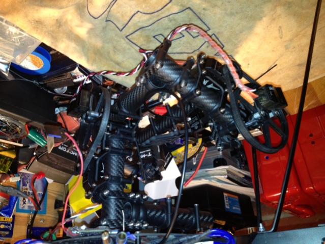

Got a quick flight in this morning...View attachment 9682
Vin
Hexacrafter HC650, DJI WKM, DJI DataLink 2.4Ghz, 3s 3300, 3s 5000, Aeroxcraft Landing Gear, Xoar 12x6 props, Spektrum DX8, AR8000 Receiver
TM1000, Fatshark Attitude SD, Sony Exview Had II CCD 650 Line Sony Effio-E
Fatshark Spironet Antenna's, DJI iOSD
