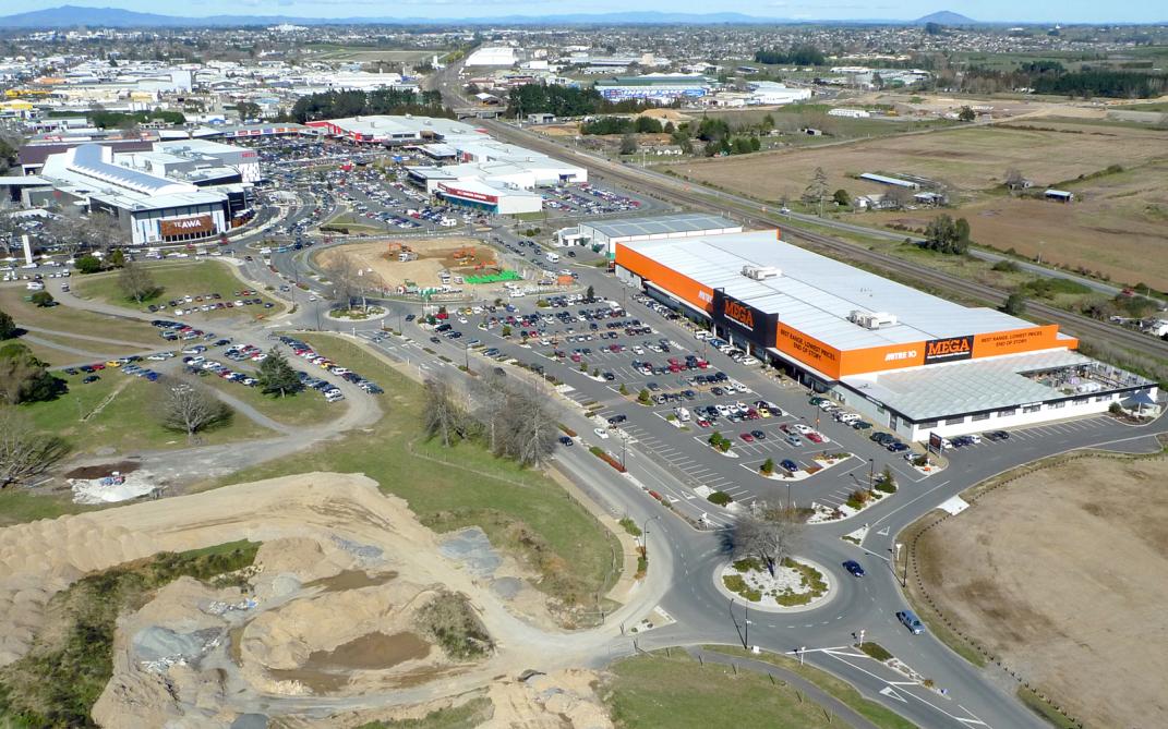

I have been using the Panasonic LX3 for 20 month now, 7000 AP shots :) As it has a hotshoe mount, my shutter-servo setup slides in there.
It does have live-view, it just isn't mentioned that you hold the "delete" key in for 5 seconds! Once on, it stays on until pressed like that again, even after repower :) The LX3 also shoots 16:9 @ 720p. At 270g grams, we replaced the Canon DSLR 400D / spycam viewer combo for the LX3 to save 500g of payload.
The quality isn't as good as a GH2 (and you wouldn't expect it to) but it has been awesome for us for roading / contruction work and real-estate.
