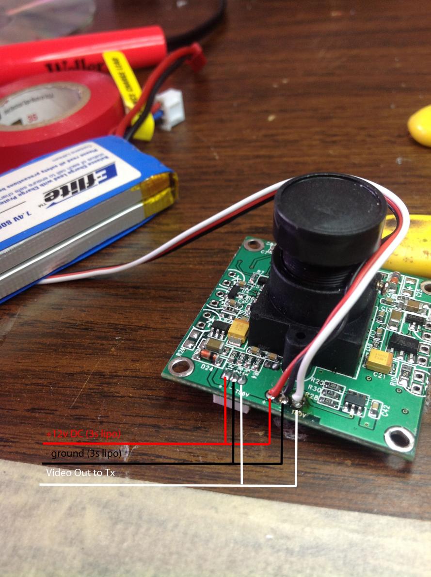

zakkhoyt
I had the same symptoms as you. Tx/Rx powered up okay, there was video static without the transmitter on, then I turned it on and just got black screen. The camera was warm. It turns out that hobbyking had the wiring incorrect where it attaches to the camera. If you look at the circuit board, it says "+", "-", "vout". They had it wired like this:
Camera Harness
+ vout
vout +
I tried to just swap the pins in the connector, but I ruined them. I ended up just soldering the wires onto the open vias. If you look at the circuit board, there are two sets of these nodes.
After I swapped them, it worked great.
BTW, my cam does not have a speaker like the one pictured earlier in this thread.
Hope this helps someone.

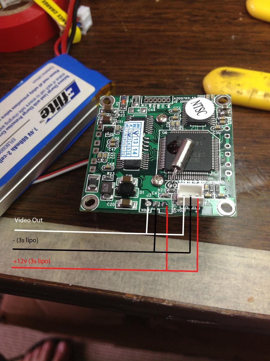

zakkhoyt
Here you go. I've taken a close up of both sides of my camera and labeled them. You can tap into the board at any of these 4 locations.
Hope this helps,
-Zakk

aWanderer
Well, thank you very much for the effort, but mine does not have those connections on the board. There IS four small holes on the opposite of the plug side, but they are not marked. I'll take a picture tomorrow and post it.
zakkhoyt
Too bad there are no labels. Here is a way to poke around if you have a ohm-meter.
With the power disconnected, find the big capacitors. On my board there are two big yellow/orange blocks (see the picture) These type of capacitors are usually connected one side to power (+12 in this case) and the other side to ground. So measure from each of your wires to both sides of the capacitors. You should find that one wire goes to one side of the cap, and one more wire to the other side of the cap. Now, through elimination, you know which is your video output. You can now figure out which side of the caps is ground by measuring to a ground plane on your circuit board. Typically, the screw holes in the circuit board are grounded (if there is exposed metal).
Again, this is just a technique that you can try. No guarantees.
Good luck,
-Zakk
