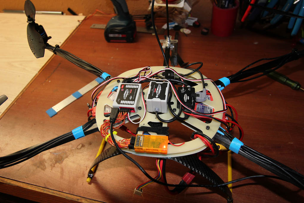

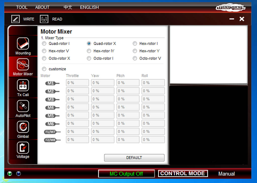

HI guys got all my stuff mounted and starting to test. Bare with me this is my first build and i’m not familiar with alot of the terms so I might have something obvious going on here. When I try to lift off it rolls hard to the right and I’m not sure why. I’ll post my set up thanks for your time.
First photo is my wookong set up as a X quad and the front is facing us or towards the bottom of the photo.
2nd photo is my page 1 on software
I went with IMU facing forward

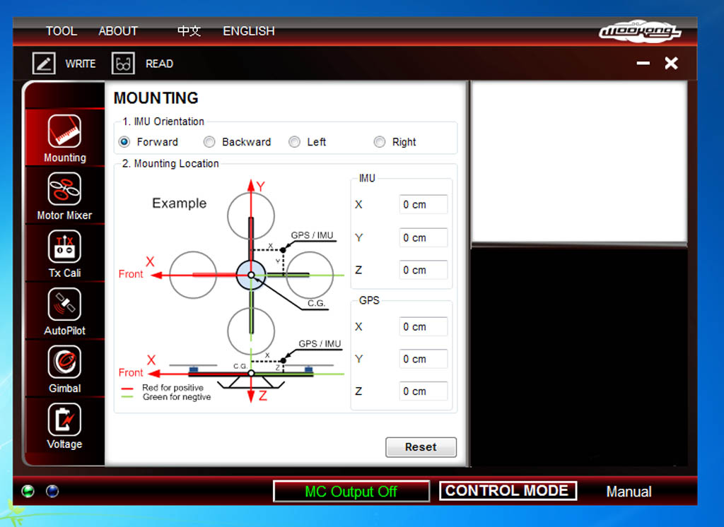

3rd photo
have quad x mode

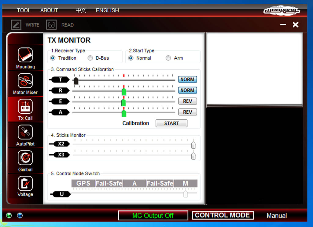

my tx monitor.. here was a little tricky...
It said if I move aileron slider left that should be left and right should be right.. well when i took quad out it was backwards.. so I hit reverse servo on my radio.. still did not fly so recalibrate with software and then same exact problem.. maybe I have IMU set wrong .. should it make a difference if I just reverse the aileron servo in my radio?
Photo 5 just shows when I move aileron stick right the slider went left

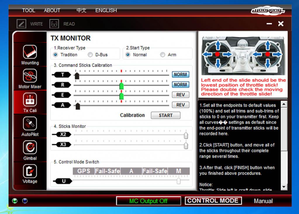

photo 6
this is where I put my control mode switch set to a 3 position stick on my DX 7 Spectrum radio. When I have stick all the way down it goes to M and makes it blue, but when I go middle position on the switch on the radio the slider goes to the A but it stays gray and says fail -safe at bottom right of screen on software... the when I go all the way up on the switch on the radio to the 3rd position the slider on the computer software goes to the GPS but it stays grey and in the bottom right part of the screen it says fail safe again.

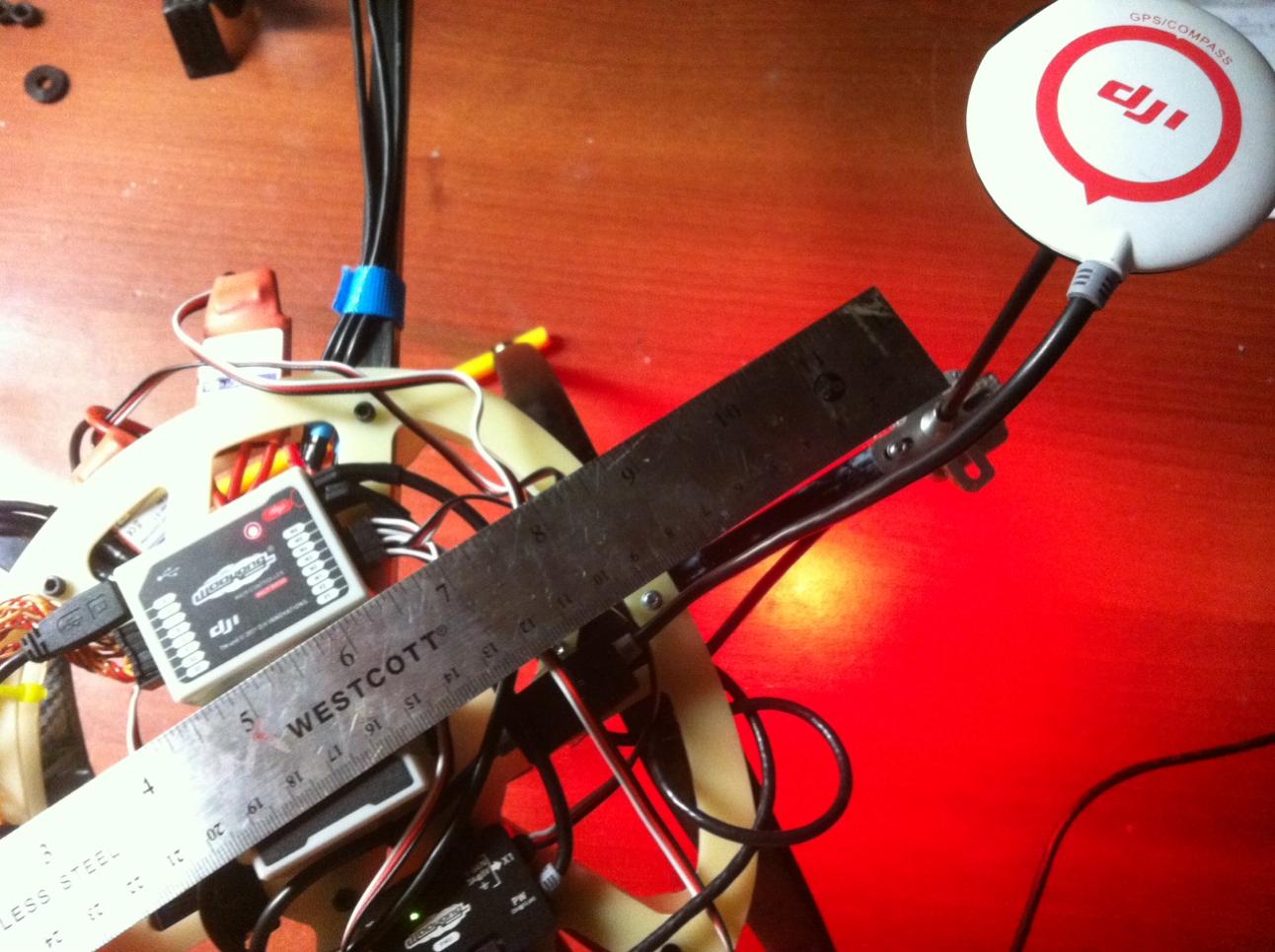

Hey Boris glad your still up or just got up. I think I did make a mistake .. I put the GPS as 30cm up on the z axis from the ground...
Should I do X axis from the center of gravity? How about the X is it okay at +18 cm
From center of gravity up on Z axis you think should not be +14 it should be -14?

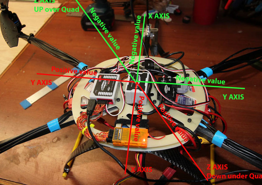

Emo please post a screenshot of your mounting config page so i can check it out with the picture of your setup.
With the current values you have !

Emo cant trust me completly at the moment it might be the fever speaking but your value for the mounting of the GPS should all be negative since in the green area. IMU you should be good to start with 0,0,0 check out the illustration. Your quad is not to heavy you could find the CG on the Z axis later for fine tuning.

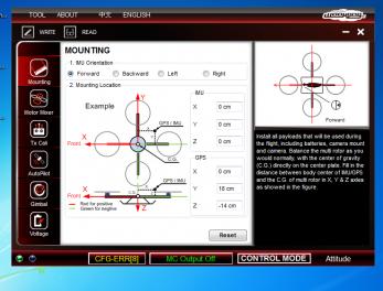

THis is my new config settings... I just changed the +30 which was from the ground to now -14 ... but it is dark now so no chance to fly it i will try it in about 8 hours when I wake back up.
BorisS
and it think you have the X and Y axis mixed up GPS is on the negative x axis backwards, z axis seems to be right now
BorisS
Okay so you have 0 x,0 y,0 z for your IMU, that okay
and for your GPS you should have -17 or -18 on x axis, 0 y axis and -13 -14 on z axis.
Watch out that your little red arrow on the GPS modul is really pointing forward straight.
