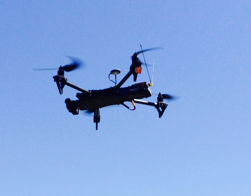

She's up and flying

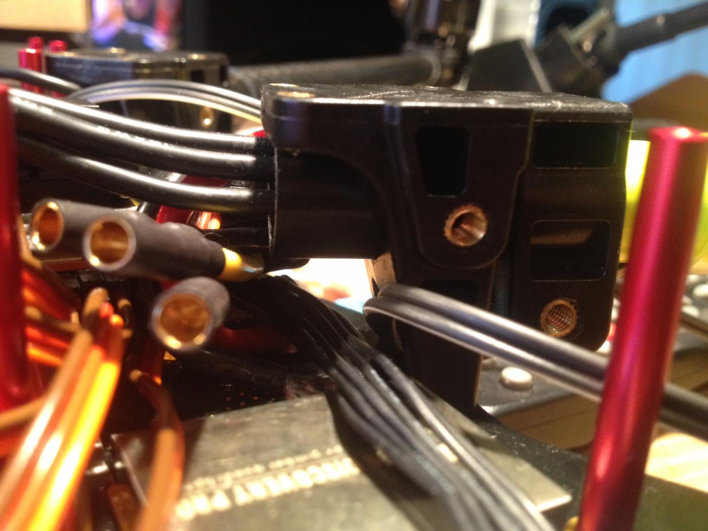

With the aerial mob booms are you meant to cut away a section on the front right boom so it doesn't hit the gimbal bracket or am I just putting all the booms in too far?
Photo 2 is how I've put the booms in which gives a boom length between the engine mount and frame bracket of 24cm
Photo 1 shows how far out I need to put the boom or cut a section out so it doesn't hit the gimbal bracket
View attachment 17504View attachment 17505
if it is hitting the gimbal bracket trim whats hitting and make sure it is pressed all the way in like you have it.... otherwise it'll act flexy not pressed all the way in
