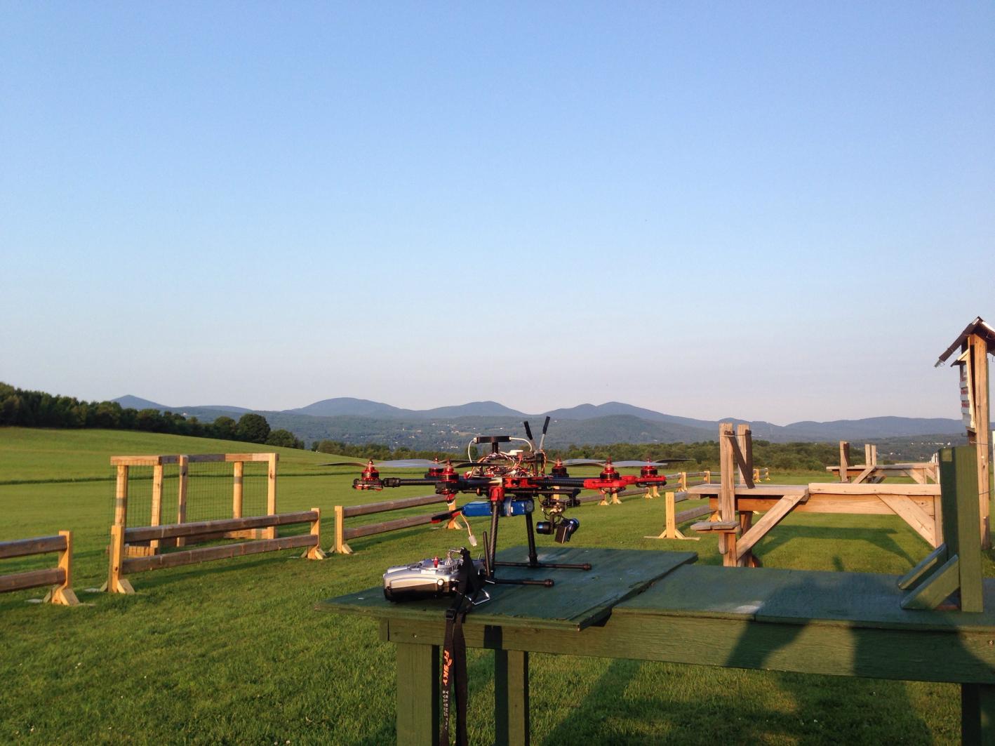

thanks so much. I'll try that tomorrow and report back. This "big" MR has been kicking my *** :). Fun though - especially when the wind does down and there are plenty of green mountains to film...
