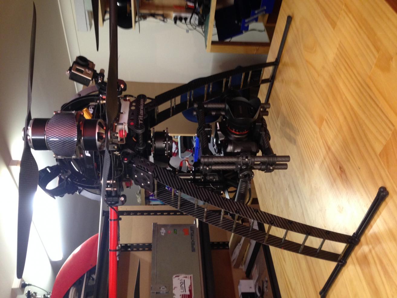

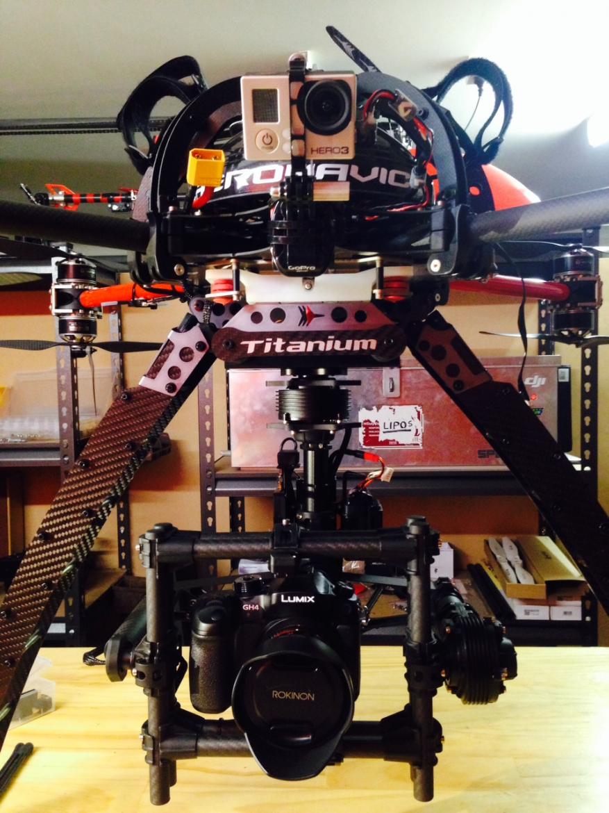

I've been following this thread... and decided to go with the droidworx extended retracts instead of the MR kit. With the Movi adaptor plate from DW as well, the M5 bolts right on. It's a heavy setup (now 10KG) but should be worth it.
I had the MR pan bar attached to my Movi and cut it down to size so I was able to get 360 degrees turns with the landing gear down, otherwise the bar hits the legs (It was just a safety precaution as I did not want it ever jamming with the retracts if it wasn't forward).
This can only be done if using small cameras like the GH4 as it can be pushed almost all the way forward, it wont work with heavier cameras as the COG is farther back.
I have heard the X4 is not affected by the yaw problems with the extended legs, but just give it a test.
Fly fast forward with the retracts up and yaw left/right, then put them down and see if you get any difference in yaw speed.
Think it is a problem only on the flat config though.
