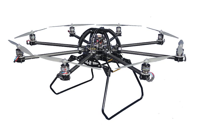

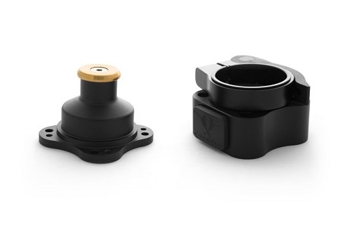

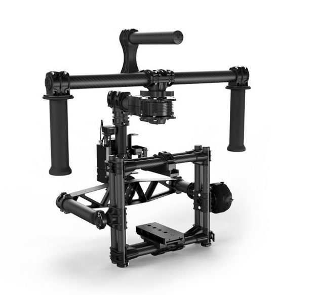

Guys I would like to ask your opinion on the current options for mounting a Movi to a Skyjib frame Vi or V2,
I know of the Eco Mount it works and its for the CS gimbal and or AV200 I am guessing it will work with a Movi too
but with the recent release of the very clever and simple design Toad in the Hole from Freefly is any one adapting a vibration system for the Skyjib frame that would work with the Toad part
thanks

I am currently using a SkyJib 8 Ti-QR with retractable gear. Fly a Movi 10 and us a Toad in the Hole. It works wonderfully! I bolted my Toad directly to the SkyJib's QR camera mount.

I'm amazed by this - I'm using the M5 with Skyjib retracts and there is no way close to enough room to use the Toad with it - I've even had to attach some pipe lagging to use it without the Toad. Is the M10 smaller height wise to the M5 - With a Nikon D800 its about 310mm from top plate to bottom

Just had a play around with the legs tonight, and seems that the 440mm ones will be good to go, it adds about 4 inches onto the normal ones.
The bottom of the gimbal will be about 40mm above the ground when level (and almost touching ground if not powered on and hanging) when the toad in the hole is added, just need to drill a few holes now and get it rigged up properly.
The toad in the hole is ingenious quick release, but very simple, and lets you go from hand held to flying in seconds.

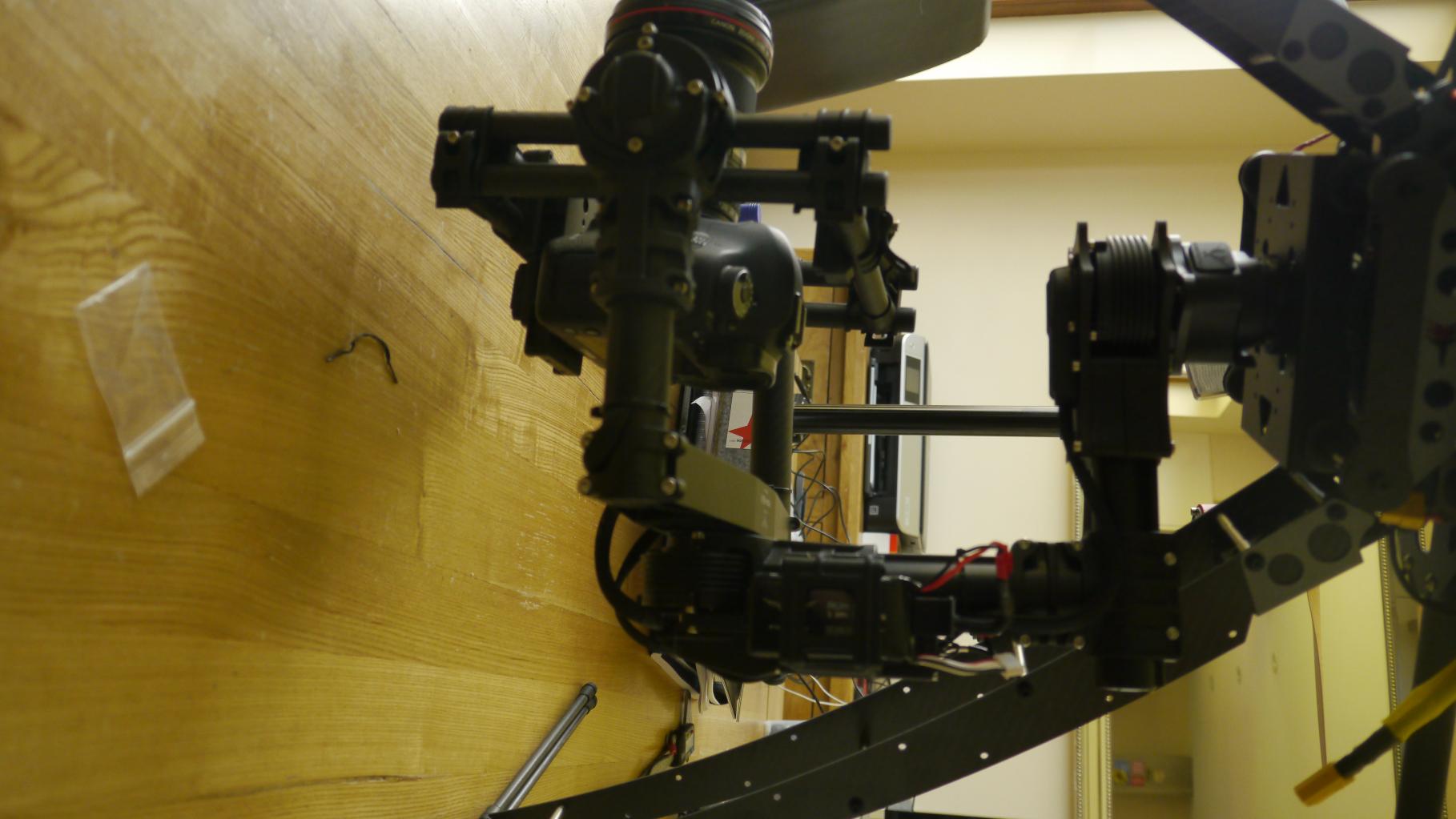

The toad in the hole is great, here is a picture with the 440mm legs, however you really need to ensure when you initiate the gimbal that the front of the motor is pointing to the front, as you can see there is not enough distance to do a 360 with the legs down.
