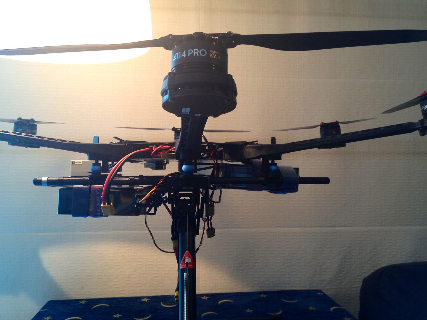

I dont have a zenmuse connected yet and have a 2 battery setup Thunder Power 7800 - 6S PP25..one under the supplied battery plate & the other strapped to the front plate but its about 5 cm higher laterally than the one at the back which i suspect is not good..I think i need to get a spare battery plate and connect it to the H frame before I fly...are there some more exact ways of determining the centre of gravity accurately?
I attach a pic of the setup..to indicate the battery placement.

As for your batteries, can't you mount both batteries to the same tray? I use a dual 6S 6000mah battery setup, and I have both of them mounted on the one battery tray that came with the S800.
One last recommendation... from the picture it seems like you might want to do some wiring tidying up. You don't want loose wires that flop around and could get into the prop area or snagged on anything while your carrying it.
