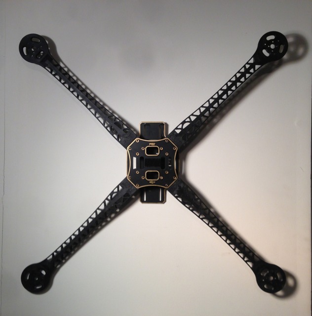

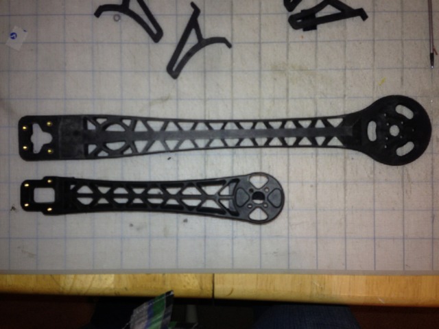

I jut got a set of the RC timer extended arms. They seem pretty nice so far, but I'll revisit this after I've actually flown with them. They are much longer, and surprisingly have less flex, than the originals.

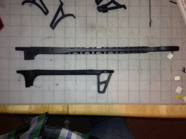

I put them in an old 450 frame I had laying around it it increased the motor to motor length up to 70 cm. the only thing that's a little funny is the height of the arms. They are actually shorter than the stock ones.

I had no idea it was that much bigger. That'd make a killer set of arms to try the x8 with it. is there a choice of length

They only have one size listed on their site right now. They also offer this as a whole frame kit with their clone F550 frame hubs. If you order the arms alone, but sure to order screws. They don't use the standard DJI screws, it's one size larger.

WOW, that 450 is big now :) .. I guess it would make it more stable, are you going to put landing skids on the bottom of the 450?
Kilby
I actually never intended to put it on the 450, but they do look cool on there. That was actually just a spare frame I had hanging on the wall as decoration. Originally, I got these to use on my F550 which would make it the same size as an S800. Now I'm not sure what I'm going to do. I have to wait for more parts to show up anyway, so I have a little time to think it over.
