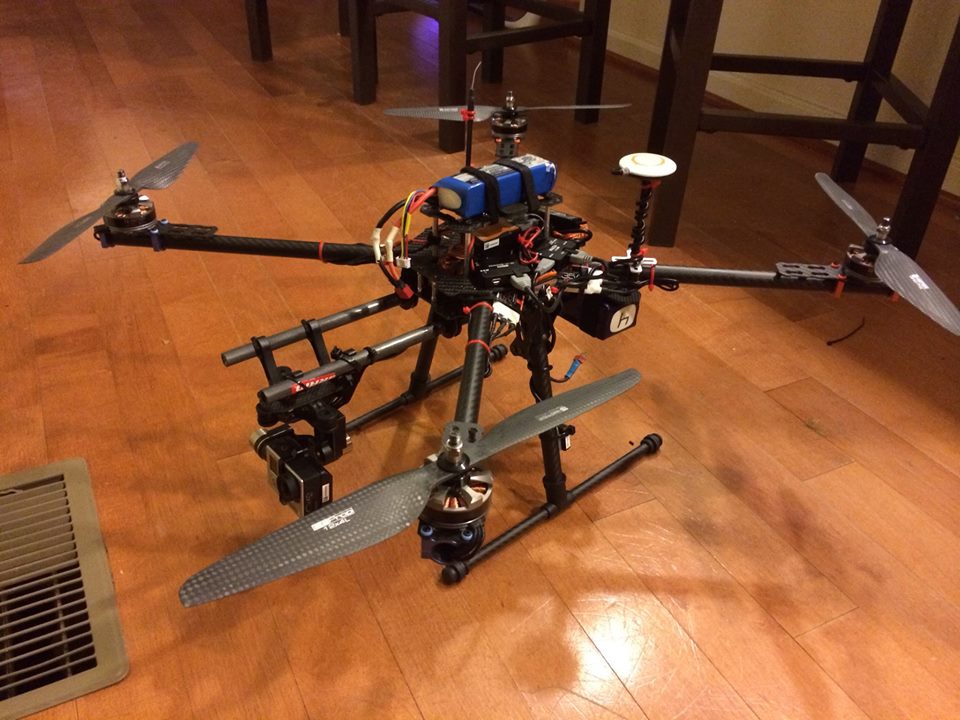

I have a Tarot 650 Quad with T-motor 35 amp opto esc’s, Tmotor 740KV Pancake motors, DJI Naza V2 W/GPS with a Zenmuse 2 axis gimbal
RTF with a Hitec receiver or I can remove it.
It’s a 4S system that can fly easily for 12 minutes (probably 15) on 6000 mAh of batt.
Total of around 30 minutes of flight time on this system. Just had too many Gh3 sessions and then Ohio weather has sucked.
Frame= $150
Motors $280
ESC’s - $120
Zenmuse- $350
Hitec Optima REC $75
MISC $50
Tmotor Props $116
TOTAL $1141
I’LL SELL FOR $775 + SHIP
PM me if interested!
Top Batt is 3S for gimbal, back batt is 4S for flight.

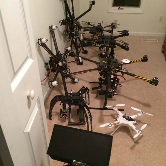

This is just the NORMAl stuff.. my hobby multi and work stuff is in another room, as the movers do not get to touch it!
NEVER AGAIN....
Part of the fleet waiting to move...
