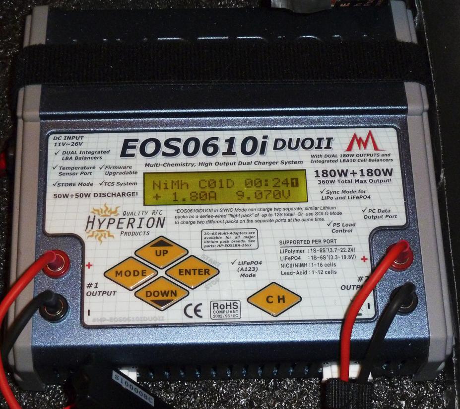

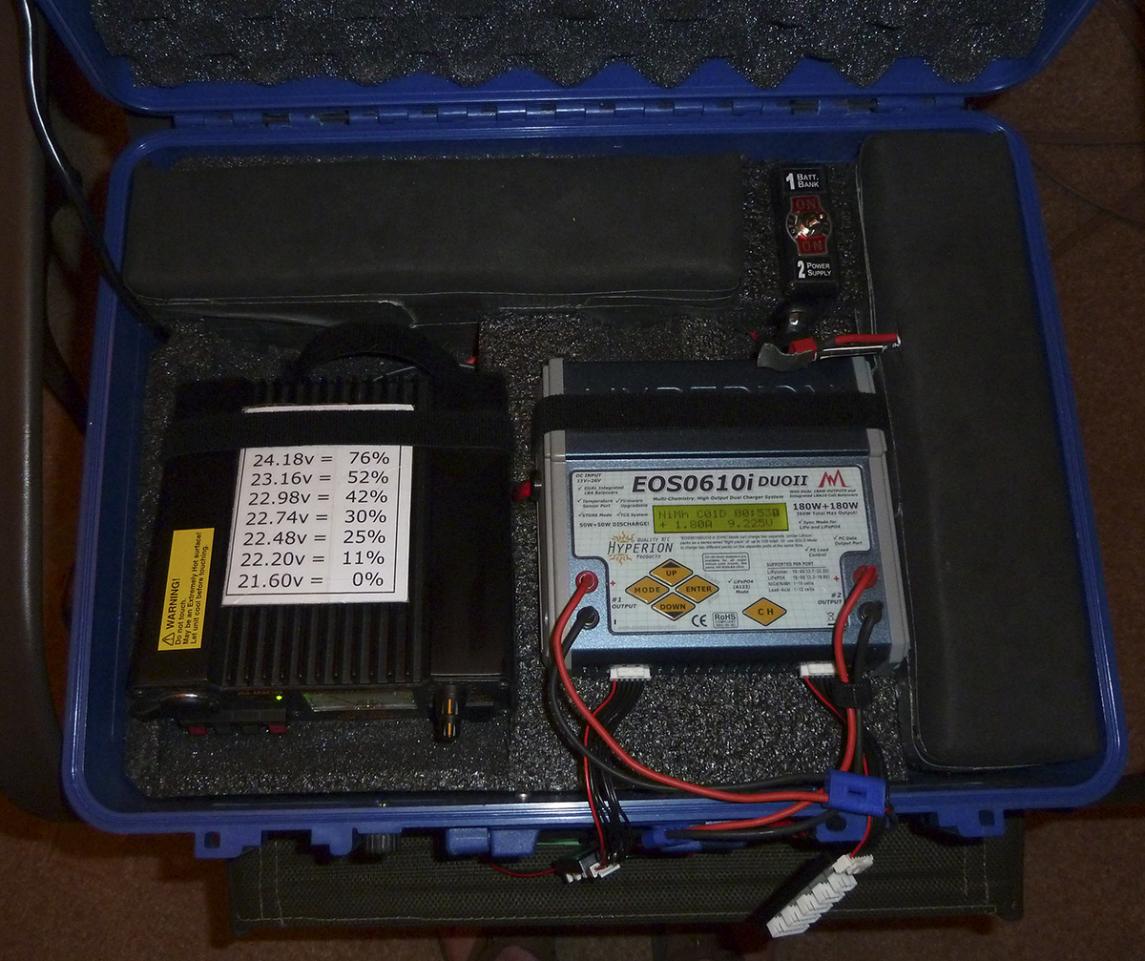

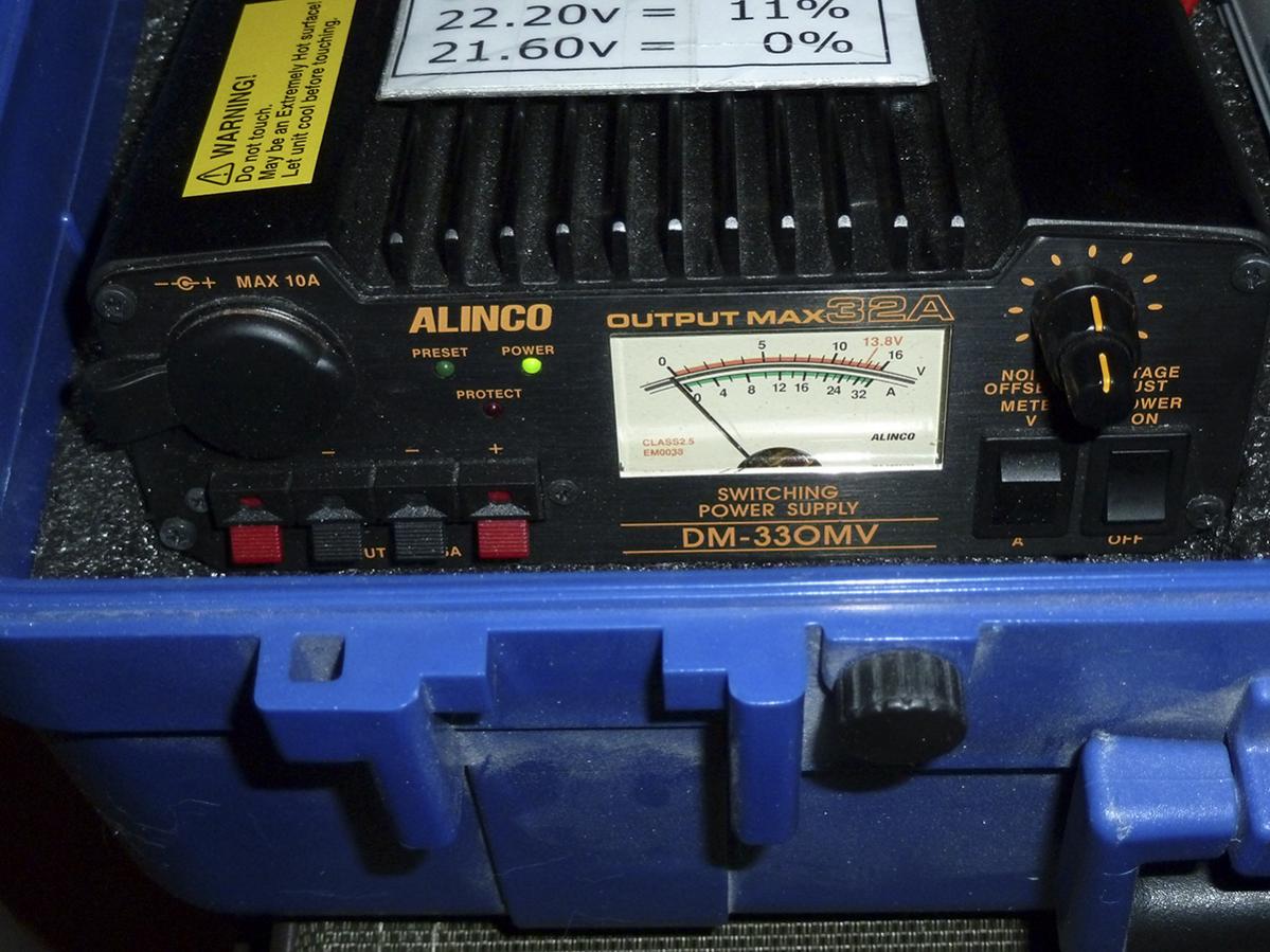

Since we're talking spare parts do you have your charging system? I need to upgrade to a 1KW system because the one I have can't charge large 6S LiPo's fast enough. Hadn't thought of selling it but figured I'd ask just in case you're in need, I'd do you a reasonably deal....a very good system (Alinco DM-330 MV P.S., Hyperion 610i Duo (180W x 2)). The rectangular shapes are two sets of 720Mah 12v gel cells (4 total) which allow charging half a dozen 3S LiPo's in the field. I'll probably keep those for my UPS...too expensive to ship and only about $40 from your local alarm company.
