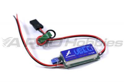

I bought a ubec like this to power all my lights directly from the main lipo at 5v:

I use the one Gunter just posted on the extension PBC.. I aint tried the Traco.
