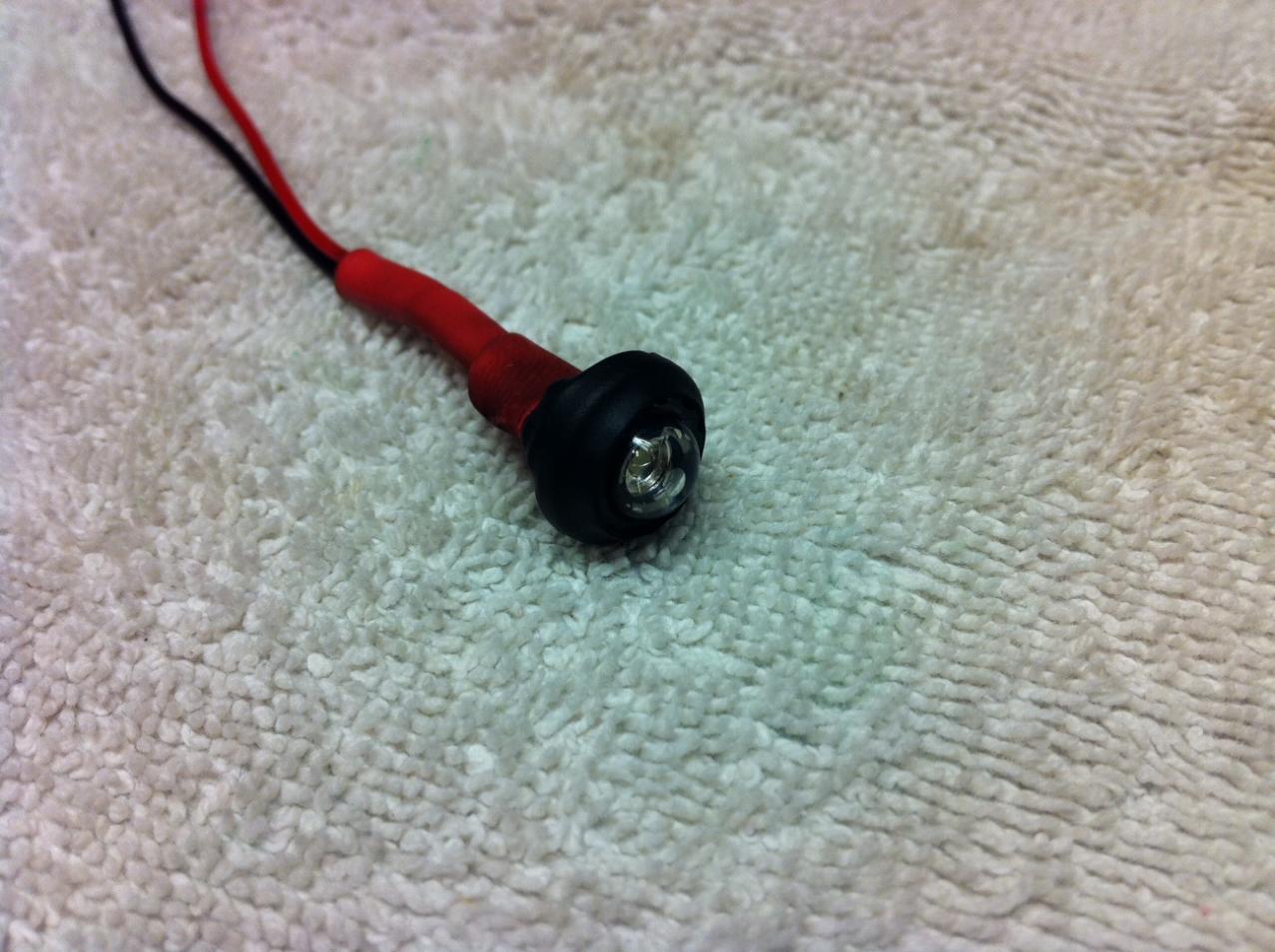

Not the best pic but I used shrink wrap to cover the connections then braided wire sleeve. I will be drilling a hole the size of the LED globe and hot glueing it in place. Altwernitavley the lot in a price od plastic tube cut just long enough to take the connection and add the resistor further down the line
Perfect, many thanks for the pic. I'll pop out to the workshop and try that now quickly!
I like the braided sleeving, I'll have to get some of that for my build.

I forgot to ask, are you putting the strobes into LED holders? I found the field of view a bit less when I tried it...

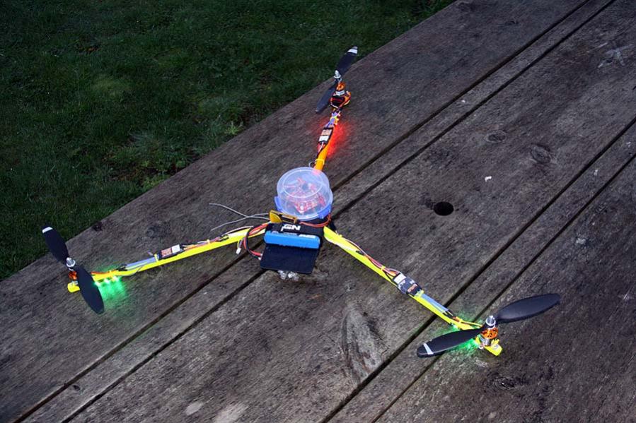

Very good Dave, looks great. I am planning to do a similar thing with my flashing led's, but wondering if they need to be further apart, so they are more visible from a distance? I think the 2 lights might look like one from 30 or 40 metres away?? Not that it makes a difference!

Na.. they are as bright as the sun! Even in direct sunlight they are distinguishable... At night they are SUPER BRIGHT... may be even a litttle to bright..
