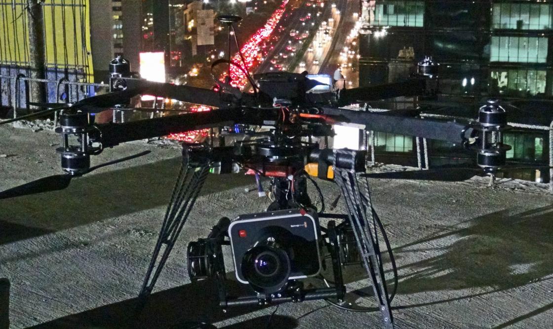

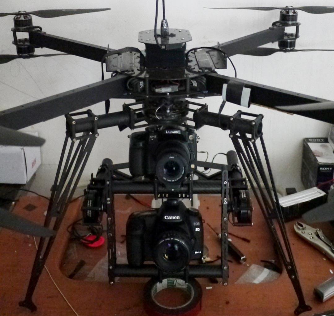

Im using KDE 35A ESC on my X8. WKM, MN 4014 kv 330, Tmotor Props 17x5.8.
Esc respons faster than my old 400mhz simonk esc
Ary
Has anyone run the KDE esc's off a Wookong and experienced any problems? Will any of the esc settings have to be change in order for them to work well with the flight controller, or is it a case of you can simply hook them up and away you go?
