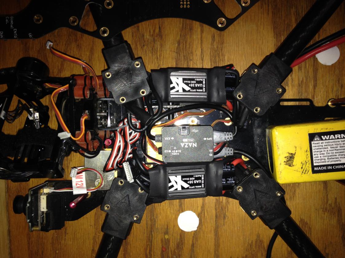

KDE started shipping there new line of XF series esc's this week, my fleets transformation will begin today...... You want to talk about some sexy little esc's, this would be them. they got a nice little heatsink wrapped in the package, these oughta get-r-done
I'll be installing 35 amp and 55 amp into 3 rigs and will keep my findings on this post, stay tuned.

Unpacking they remind me of opening a new pair of shoes, smells just like it....

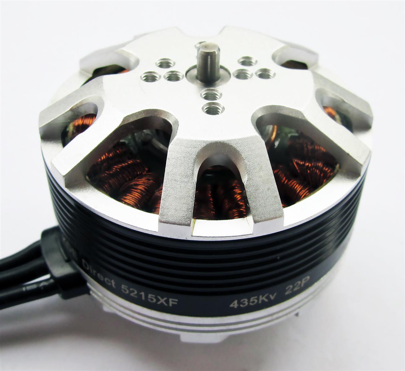

the KDE5215XF are amazingly nice inside and out,,,,,, there just getting the testing underway but these things blow away the u7 by a long shot from what i'm told.

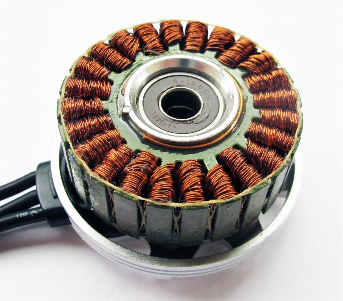

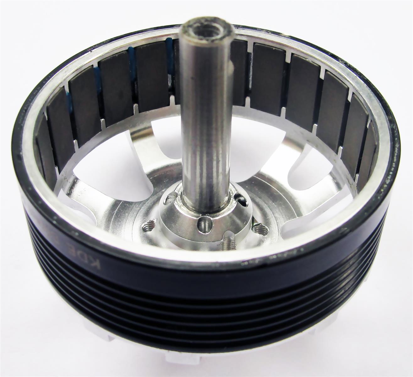

Here’s a few sneak-peak pictures of the design and I’ll have full Dyno-data soon – there’s no doubt, these will CRUSH the U7s, both in torque and efficiency. I have no concerns there…purely by the electromechanical design, these are true-industry grade products. everything will be cleaned up more for final production (cleaner windings, surface finishing, etc.).
View attachment 18686View attachment 18687View attachment 18688View attachment 18689
everything about em is amazing, none of that stuff is inside my u7's....
