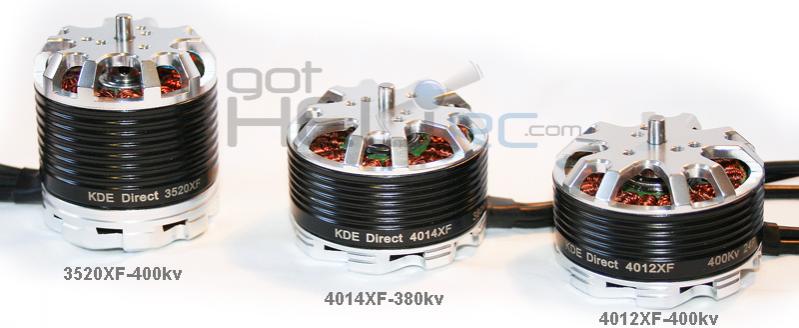

Amerly
They are here!!! Bench test are incredible, running motor at full speed holding it in my hand and barely can feel that it's running... freaky awesome.
Here's the three together for size comparison.
