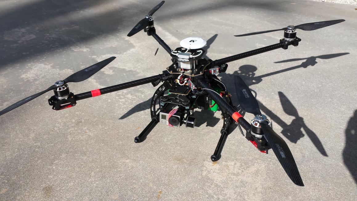

So the 2814 515's are working out fairly well so far. I mounted them up, and when running it with no props, they are very quiet and smooth. Hard to say if they are better or worse than iPower motors, it's been a while since I felt those. But way better than Turnigy NTM motors.
I'm using the DJI 15" folding props. The vibration was initially higher than I'd like. Z was good, but X and Y were about +/- 4m/s/s on Arducopter. This should be under 2. I suspected that the problem was the props were too tight, which wouldn't allow them to fling out straight totally. I had them not hard, but not loose. I loosened them. The vibes are now about +/-1.5 m/s/s. I heard these props do vibrate more than solid ones. I'm OK with that as long as I can get good video which is TBD. I'm a little concerned the prop screws are ridiculously loose now though. I have loctite on them, but it's not really even setting because there's no load.
So, with AUW of 2100g, it's drawing about 12.5A in a hover. Looks like I have a 30+ minutes with 4S 8000 Multistar batteries. The motors are outperforming the eCalc simulation. 3.12A each vs. 3.75A. So that's cool. After flying for 20 minutes, I landed, batteries are still at 3.85V. Motors are barely warm at all, hardly detectable. So seemingly no problem at all with the 15" props on 4S.

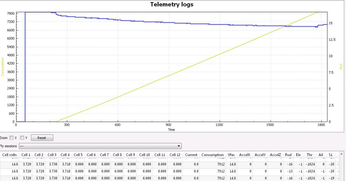

Good results so far with the 10AH4S Multistar 10C.
