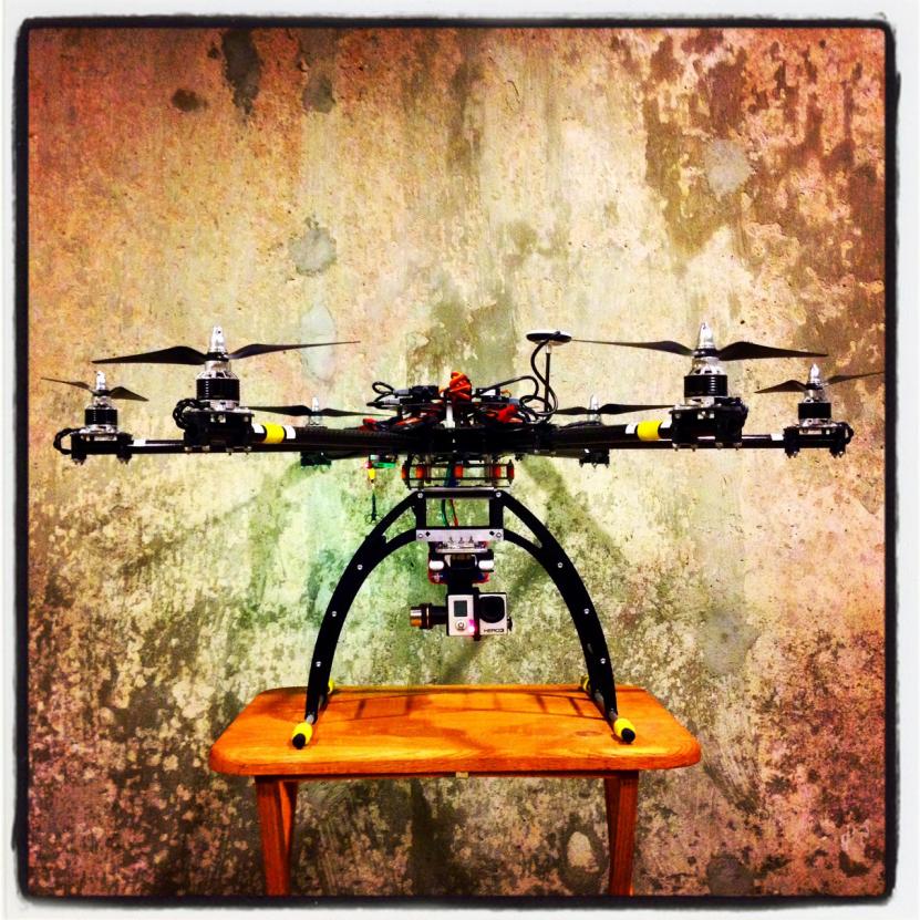

I have to agree with synrg, these KDE 2814 515's are beasts! I've been testing them on my Rusty's UAP1 800cm hex with NAZA V2, 14" Gemfan CF (T-Motor clones) props, 5000mAh 6s with Zenmuse H3-3D and have been VERY pleased with the results. Many have told me that the NAZA shouldn't be used on a craft this size but I have had no problems over the last month. I tinkered around with props size starting at 11" going all the way to 14". I did not notice much difference in performance, motor temps were never a problem and even though eCalc said these would be more efficient on the smaller props but I find the 14" are nice and the extra lift is sweet. Easily hovers at 50% and I get a solid 10 minutes of mixed flying, some aggressive passes and easy cruising. I could probably get 12-13 easy minutes since I land with about 34% left in pack. AUW is under 4k. At the 2:24 and 4:50 marks you can see I've got the throttle just about pegged as the arms and motors come into view.

Wow, that's one hell of a MR to carry a GoPro.. Its also about the best fast forward flight I've seen from a GoPro, or any other kind of camera for that matter.
Nice setup.
