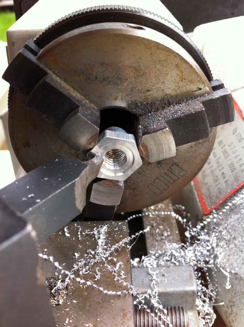

helifotos
Here is my way to fix the e-prop problem on the axel :nevreness: , take out some space under the top nut, no washer needs....
